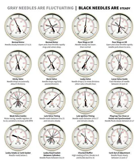

Vacuum Gauge readings can help you diagnose blocked exhaust and other problems.
Reactions: 2 users
