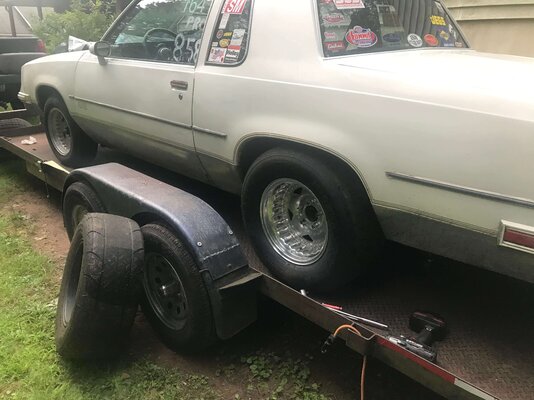

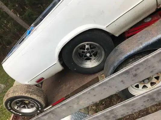

I race with some 275-60-15 Mickey Thompson Drag Radials. a 15x8" wheel with 4" backspacing fits great! a 4 1/2" back space will fit, but the inside tire sidewall will probably rub the frame (So, Stick to 4" BS)
I also switch them out at the track. the car sits on some 15" rally ll's with 235/70's
