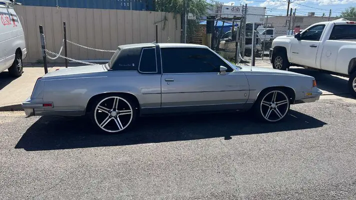

Nice Cutlass. I currently have 235/60/R15’s on my 79 Malibu and they do not rub at all. A friend of mine has 245/30ZR20’s on his 84 Cutlass and he says they barely rub turning into a driveway at full lock.
