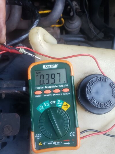

I tested the wire and only reading i got when the ignition was on was 0.397 I even used a test light but nothing came on. Is this the normal reading.

I have no idea what the reading will be I don't have a CCC car to test. I would never use a test light on a computer circuit, it could draw too much current and damage the computer. The multimeter has a high input impedance and should be fine to use.

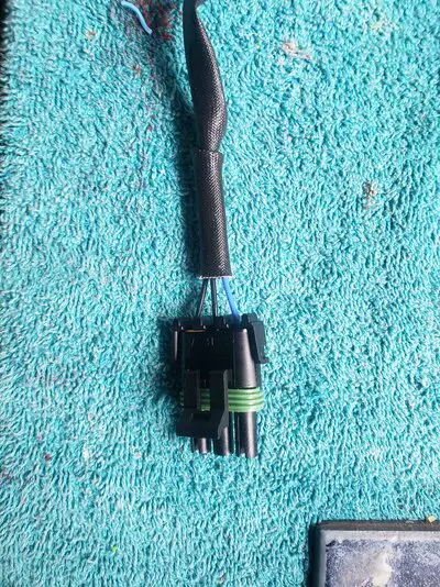

This is the replacement connector the connector pin matches what you have and the rubber weather pack seal seems to match what you have left on that wire.

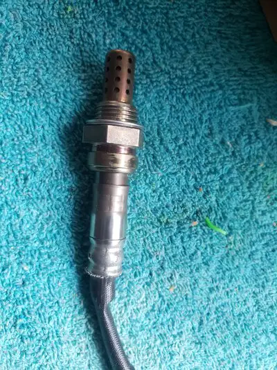

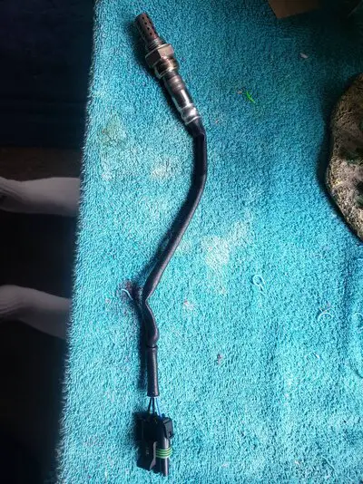

I got my sensor and am getting ready to install it i got a quote from the muffler shop for the bung. Ill be connecting it with key on to the fuse box , ground to the engine block and the main sensor. How can i make sure im hooking it up to the main sensor the only reading I got from that wire was in my last pic. I want to make sure its getting hooked up to the 02 sensor wire not trying to mess anything up. Anyway of testing it to see if it really is that wire ?
