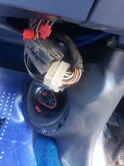

Does anyone know off-hand which end of this harness would lead to the trans? Black side, or white side? This is the harness under passenger dash.
Asking because my bog seemed to go away or at least got way better when I unplugged this. 🤔 Am I seeing a coincidence, or are these wires somehow affecting the distributor or something?
I installed an Edelbrock performer rpm manual fuel pump, based off recommendations that my fuel pump was too small...but I still have the bog.
Wondering about these wires because I have a switch wired in for lockup and if this harness is disconnected, want to make sure lockup is still getting activated (trying to save myself some time hunting).
Also, is there anything there I need plugged in?

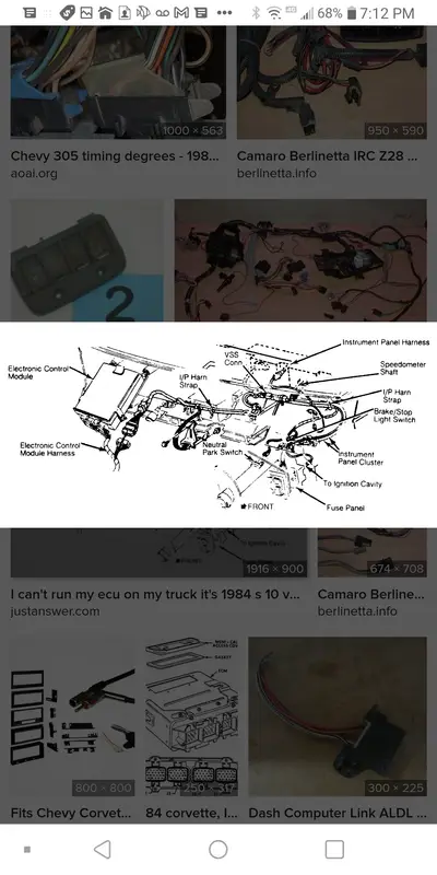

Need someone else to chime in, but I think those connectors go to the ECM. Notice two connectors to left of ecm box.
See screen shot attached.

Does that harness connector happen to be located on the passengers' side of the cabin adjacent to the kick panel mounted down low on the A-pillar? If so, then carefully pop that kick cover off; it just snaps in place and take a look behind it. if you see a silver/aluminum colored box, your are looking at the CCC. It is NOT a computer, it is more of an electronic idiot-savant that takes input from solenoids and sensors that would have been located on the original carb had it still been on the intake and functional, and uses them to adjust the advance and timing at the distributor. As noted and mentioned above, if you decommission or disconnect the CCC from its sensors, then you have to swap out the distributor and the carb for non-electronically controlled models; which you indicate that you have done.
If you want to totally isolate out the CCC, then you have to unplug all the connectors that run to it, and then remove it entirely. Any sign or hint of corrosion on the case can be a symptom of internal problems Using an aluminum outer shell to cover the motherboards was not the smartest thing the engineers ever chose to do.

Yeah, that looks about right. I unplugged the ECM but never unplugged this other connector.
The connector in question- I read that by jumping pin F to pin A, lock up engages. So, I put a switch in between A and F. Unfortunately, I can't tell if the converter locks up or not - I don't notice any feel or change in rpm, ever. I do know that F is giving A power when switch is on. 🤷‍♂️ I left this part out - I am also running a vacuum switch. So basically, I turn my switch on when I want lock up, and the vacuum switch controls when it kicks in and out. As stated though, I'm not sure if it is actually working or doing anything.

CCC is unplugged and in the trunk. Correct, I am running Edelbrock 650 carb and MSD street fighter HEI distributor. This other connector (previously pictured) apparently was part of the harness that plugged into the CCC.
In regards to that connector, I am using pins A and F to engage and disengage lock up via a toggle switch.
Being that I'm running carb and HEI, how or why could anything in this connector give me a bog?
