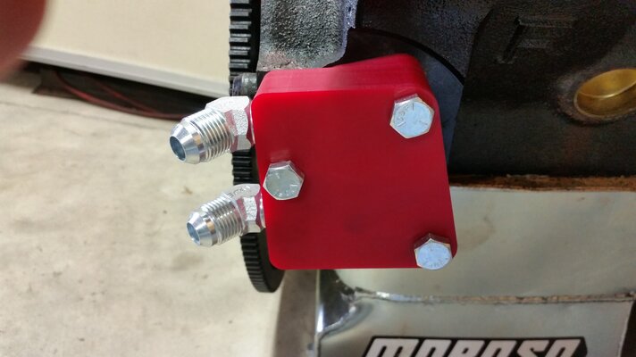

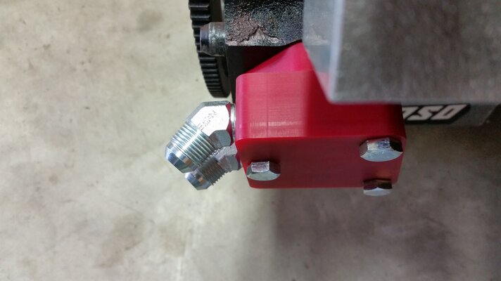

I've made these in the past. I revised the part so it does not have the counter bores for the mounting holes.
This is a prototype for a rear exit remote oil filter adapter.
