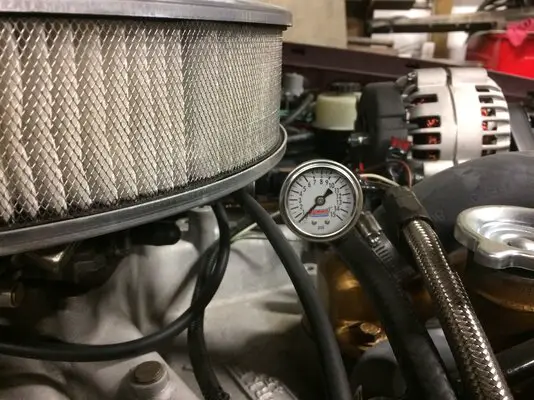

I have a flare to an adapter with 1/8 npt port right before the fuel filter inlet

#7
1bad79
1bad79
Dec 3, 2011
751
539
Allendale mi
#10
I think what I did was a 3/8 flare to 6 an male then 6 an female/male swivel with test port and my liquid filled guage that may or may not be accurate
