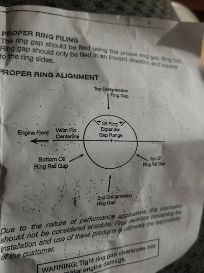

It isn't as hard to do as I thought it would be. It is can be a challenge to hold them square and cut them square but I have .017" to .019" of filling to get it right. The new little pack of files simplifies removing the burrs. Mahle says measure the rings 1" down in the bore. The instructions also say the opposite of what Mark and other sources say, more top ring than second ring gap. I could still flip flop the rings.
