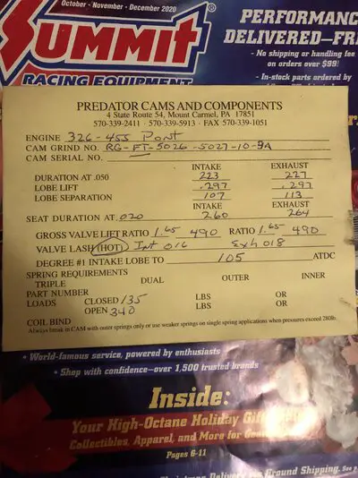

In 2016 I did a 400 engine with a custom ground solid flat tappet cam Edelbrock heads single plane intake 830 Holley stock crankshaft scat rod diamond pistons 10.65 compression if I had to do it all over I would’ve put more duration to it Engine produced 588 hp Pontiac motors are my favorite it’s where I cut my teeth but I can’t afford them
588hp with just north of an RV cam and 400”?
