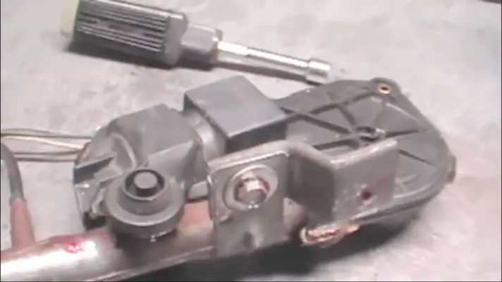

Hey guys, first post on here, had several g bodies forever. I have a 87 grand national, Im fixing the power antenna, someone before me had attempted to fix it. I have the antenna out I actually need the bracket that mounts the mast to the fender inside the door, I can send you a picture of what im talking about if im not making sense. Does anyone have one they can sell me. Ive search ebay seems every bracket is available but the one I need. Thank you in advance!!!

Here is the pic of the bracket I need, Thanks in advance

For as simple as that bracket looks, I’d just bend up my own from some flat stock. But if you want it 100% original GM and correct, then I understand that too.
Good luck.

I'm on the fence to do that, I'm just so OCD when it comes to using factory stuff if I can find it lol

That "Z" looking stepped bracket bolted on to the lower mast bracket is GM p/n 25509250. That one is going to be hard to find unless you have a Regal. Not readily available anywhere I can find.
You try over on Turbobuick or other Regal/GN forums? That's another place I'd try. Some of the parts hoarders over there may have just what you need.

Oh, forgot to add, the lower antenna TUBE bracket (held on to the tube by tack welds from the factory, and replacements are held on with 4 short screws) is part number 22038589, and it comes with the screws in the kit. The Z bracket the bolts to the fender and the tube bracket, just to clarify. So there's basically two brackets you need to find for the Regal.
