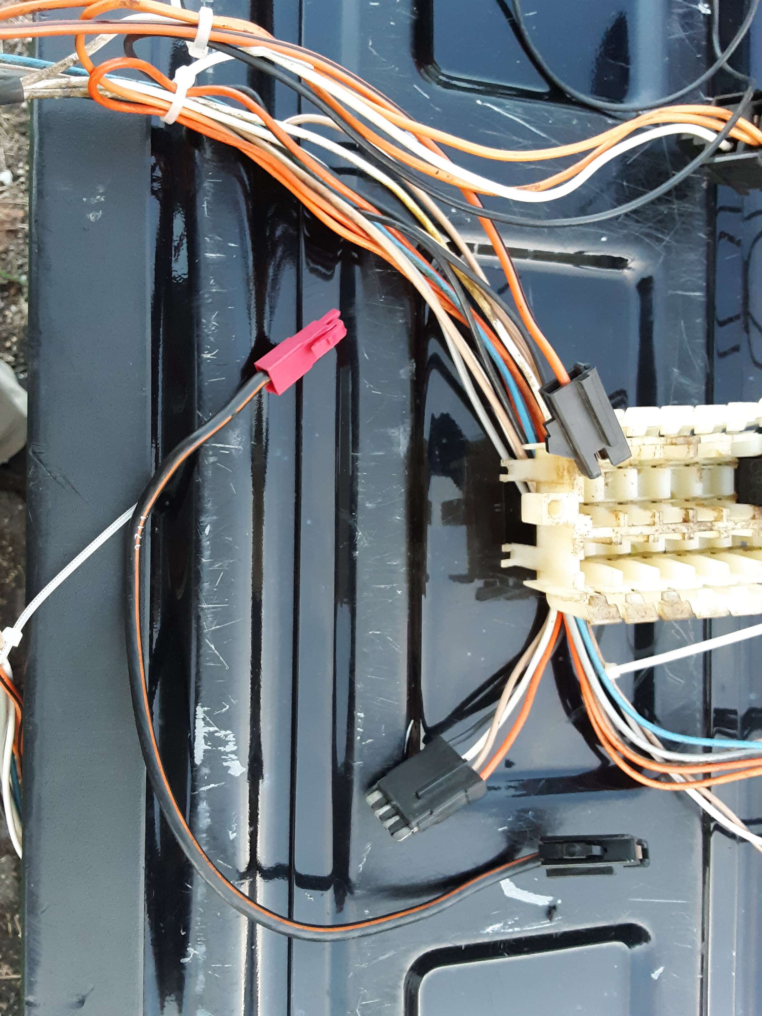

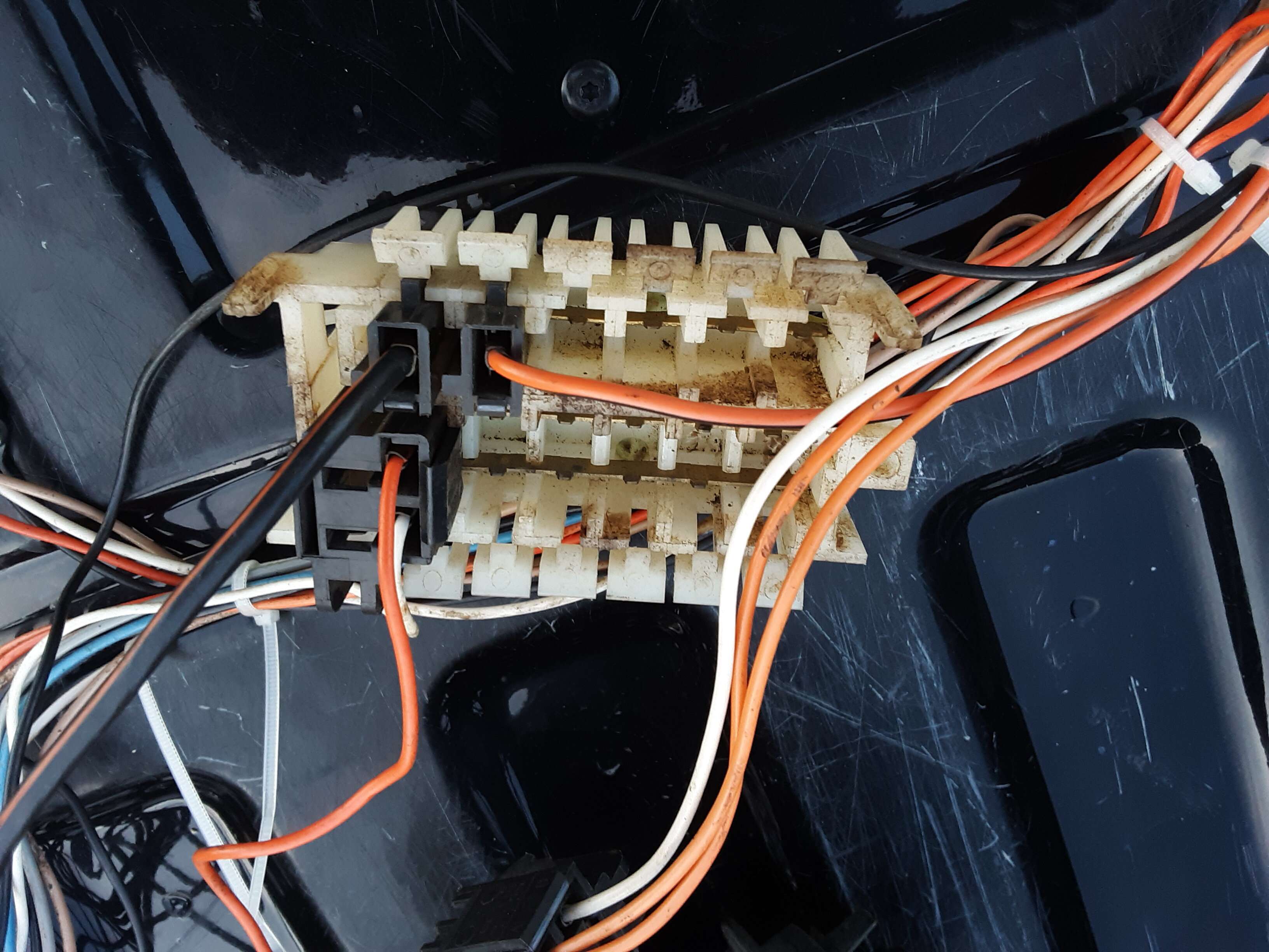

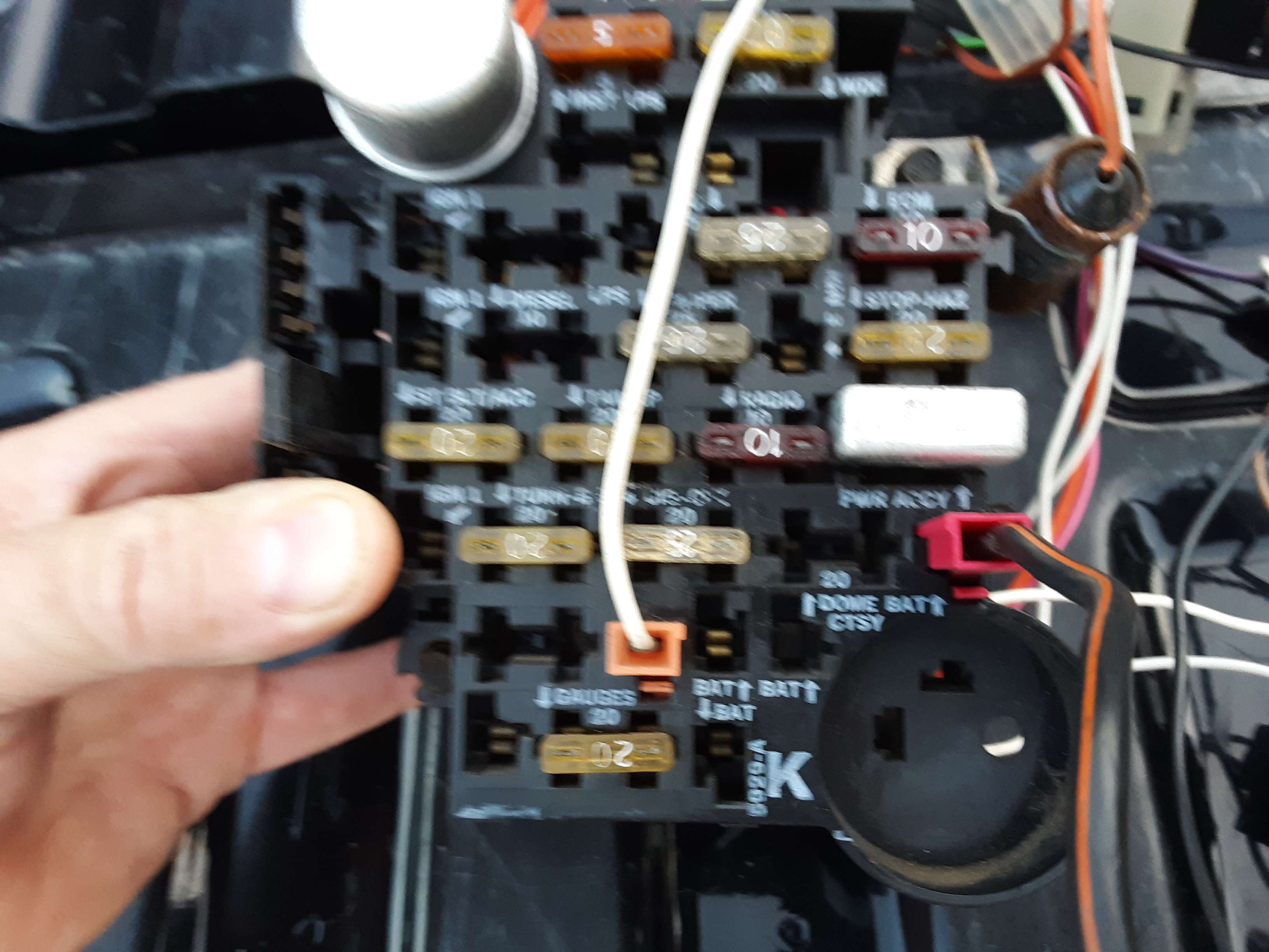

Here's some quick pics of my harness using a spare dash harness to sho how everything goes.
Here's the black orange wire in it's home in the fusebox under the needed 30 amp circuit breaker.
Here's the jumper (C353G) in C353 junction block with the orange/black(C353H) in the harness that goes the lock relay. Along with it is the courtesy light connector (C353A) that supplies power to the lock switches.
This is the four cavity Packcon conector that piccy backs the front to rear harness off the fuse box.
This is just everything loose to show the connectors.
I think I’m missing the harness that plugs into the fuse panel. There is a separate single Packard style connector running off the power window harness, could I wire the lock relay main power into that? Everything is grounded properly, but at the time I only had one actuator hooked up at the time I tested it.
And while I’m at it, any idea what the metal canister with the single orange wire running to it is? I had one on the GP dash, and it broke off of the wire.
It is possible but to get power from the circuit breaker you'll need one of those red connector & proper width terminal. You Might be able to get a lead with the red connector to splice in from a B-body.
