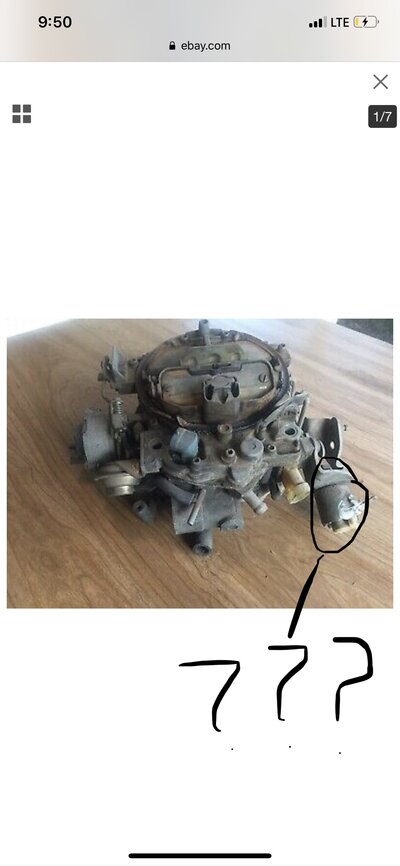

Depends on what engine/carb you have and if it matches what was original in the car. If you have an idle load compensator, aka ILC, it is different than the idle speed solenoid, aka ISS. The electric jobbies, at least on VIN 9 engines, do absolutely nothing for anti-dieseling. They lay there doing nothing until the A/C is turned on, then they pop open to compensate for the RPM drop by the A/C compressor kicking in. When ignition is off or A/C is turned off, the solenoid retracts allowing normal idle speed.What is this ? And why doesn’t my carb have one . Trying to run my vacuum hoses correctly but I’m stuck trying to figure where they could go.
The ILC works a bit differently. It does have anti-diesel solenoid and regulates vacuum to the compensator as needed to maintain idle or attempt to keep the engine from dieseling on shutoff. I have never messed with this kind of system, and I much prefer the ISS over the ILC any day. Too many moving parts for me on this ILC thing. With ISS, you can pretty much set it and forget it.
Here's a pic of vacuum routing diagram I posted in another thread if you HAVE the ILC in your 87.
Apparently then you're missing some stuff? Did someone change out the carb and not consider the ILC system? I dunno what to tell you on that. If you have the vacuum hoses without the stuff to hook it to, I suppose you could plug it off without issues except for not being able to compensate for a/c load.Mine doesn’t have ILC but has ILC SOLENOID
