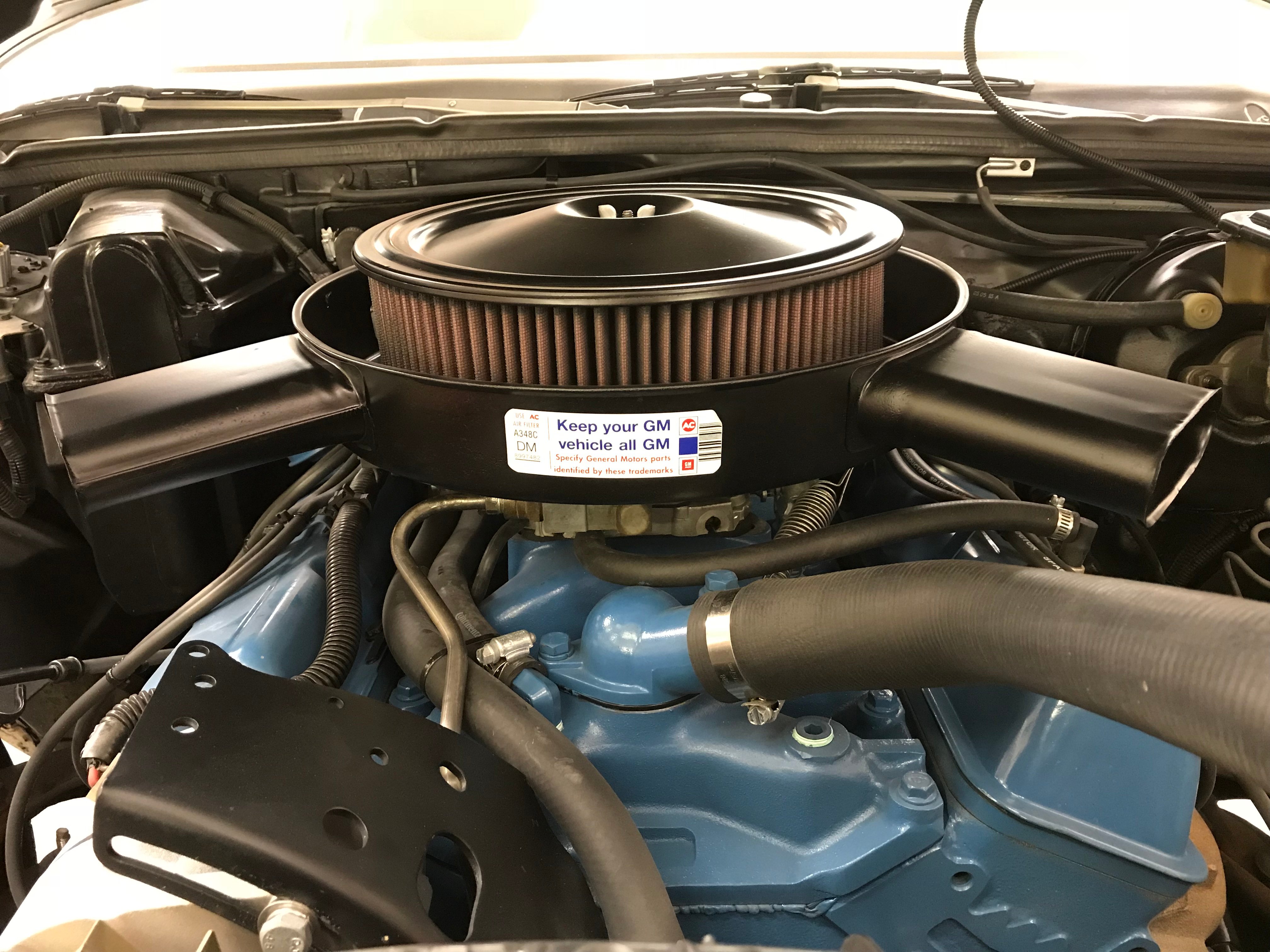

Here’s a couple of pics showing the routing.
6809acdf-7c73-4c1a-b1c3-7f54a0bf15f3-jpeg.84583
f02b8641-38fb-436e-b6d7-85380c52b419-jpeg.84584

Thank you, sir. I truly appreciate you taking your time to post a few pics of your fuel line setup. I've been running a Holley on it for years and never had a Q-jet on this engine before.
My original 305 was Q-jet equipped, but I never kept the original steel fuel line. I will be improvising and bending up a new line once I get the Q-jet on there.

I love how that engine looks. So clean.
