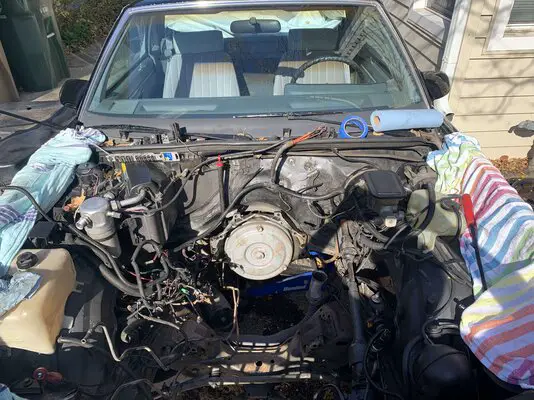

I began my ls swap this weekend in my '87 El Camino. After reading some threads here I picked up the Spohn Performance swap mounts and the CTS-V oil pan. For now, I plan to run the 5.3 in front of my 2004R. When I dropped the engine in, I got to bolted to my trans, but I don't think the mounts are sitting correctly. The top two holes sit proud of the frame and no holes align with the myriad of holes already there. On the engine itself I am running Anchor 3064 mounts for an 4th gen F body. I set the intake on when closing up for the night and it doesn't clear my hood.
Any advice form anyone who has installed these mounts? Thanks.
