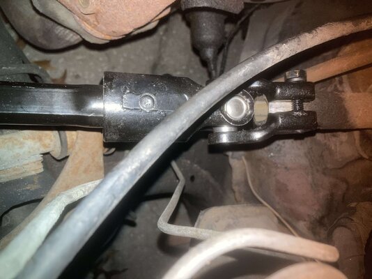

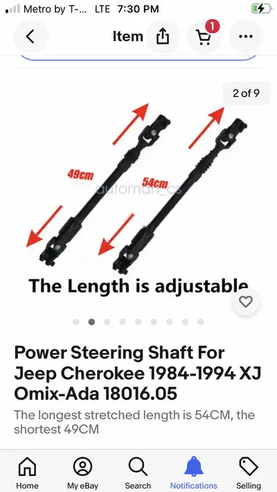

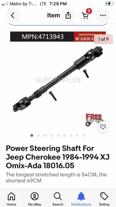

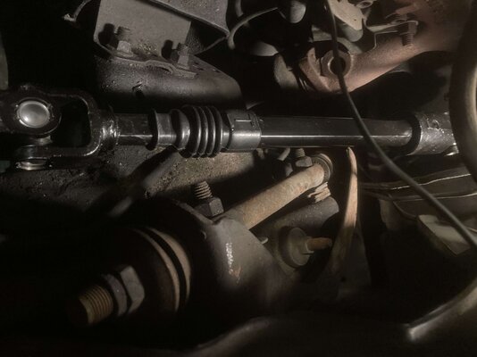

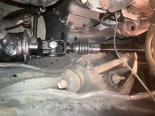

So this is where I've gotten ~
Power Steering Shaft For Jeep Cherokee 1984-1994 XJ Omix-Ada 18016.05
It was an ebay seller listing usa product but actually offshore (had a delay & offered terrible customer service)
It dropped right in without any grinding.
The 800 box is in & I just need to hose her up & tighten the pitman.
Any input ~

Just road tested nice tight feel !!!
