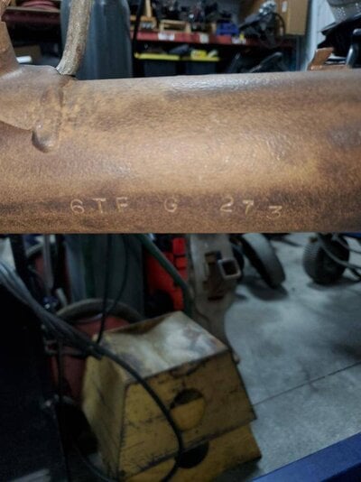

Here are the codes on the axle:
6TF G 273
From what I have found, the G indicates location of mfg (Detroit, it think) and the 273 is the day of manufacture ? I have seen a posting saying the code for a 3.73 Hurst Olds rear would be 8TF, but this stamp very clearly says 6TF. I will post a pic shortly if I can get it to work from my phone.

The pic below shows the stamping very clearly (before I painted it.) 30073.jpeg

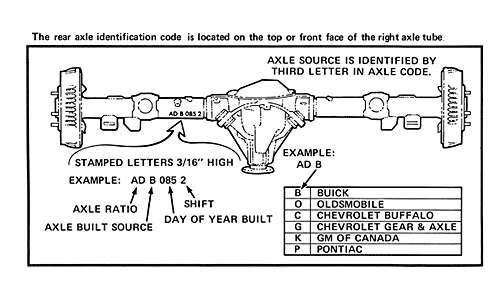

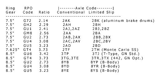

Finally! Had problems logging on. here is the information I have on GM rear axles. May be some of the same information you had found.
Here is a site that may give more information.http://tech.oldsgmail.com/axle_useage.php

For the 8.5" Oldsmobile 3.73 rears:
According to the 84 CSM, chart in the back of section 4B, 6TF is for Hurst/Olds, NON-limited slip. 6TR is for LIMITED SLIP Hurst/Olds. This is also found in the parts book information in the front of Group 5.
The 8TF and 8TR (limited slip) were for 85 442 rear ends.
86 and 87 442 had 3TG and 3TR (limited slip) for their codes.
Limited slip (G80) was an option for ALL G-body H/O and 442. IIRC, the only G-body it was standard on was the GNX.
