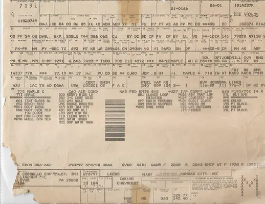

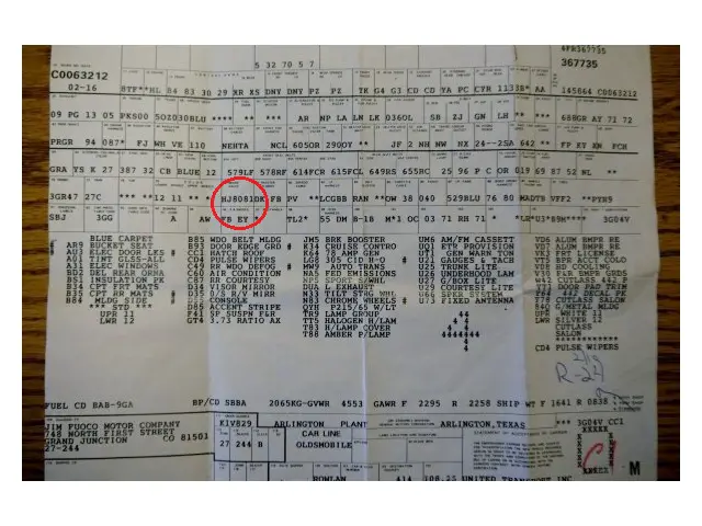

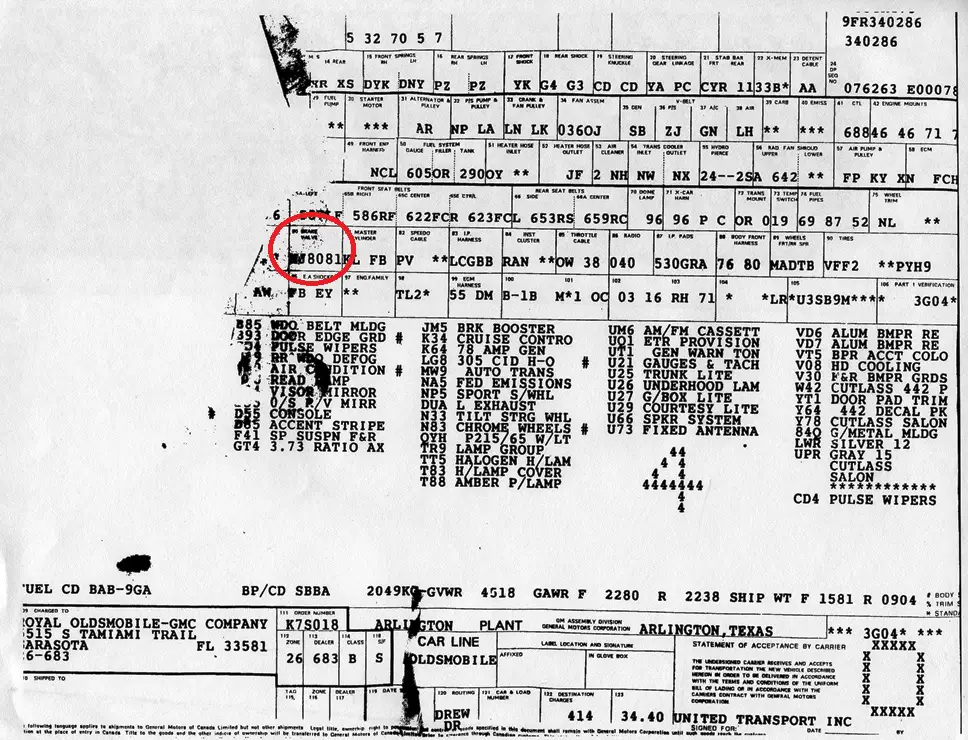

Quick buff with a soft brass brush and it looks new again. The idea is when I get to the brake line replacements, the combination valve will be a drop in and won't have to waste time redoing the existing valve. Which is also a Kelsey Hayes with code "HJ". The build sheet shows the brake valve coding as "HJ 8081" whatever the 8081 means. They sometimes put a partial part number in there along with the code, but I cannot find any reference to the 8081. Probably hit it with a light coat of Boeshield to help protect it.
