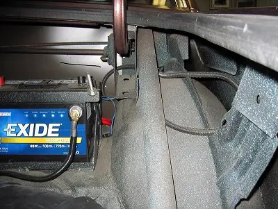

I wish I'd put a full cage instead of the 6 point at the time, but here are a couple pic's that kept the back seat and the trunk open. If your going full cage I have some other suggestions for you.
I wanted to talk to you I love the way you did the rear bars that’s the way I want mine did you run them to the frame behind the tire you have any pictures of the front bars and how they cleared the seat and arm rests I’m gonna make my cross bar bolt in so when we’re street driving my kids can ride safer

Yes - behind the tires. The full cage really stiffens the frame but I understand if you don't want to go that far.
