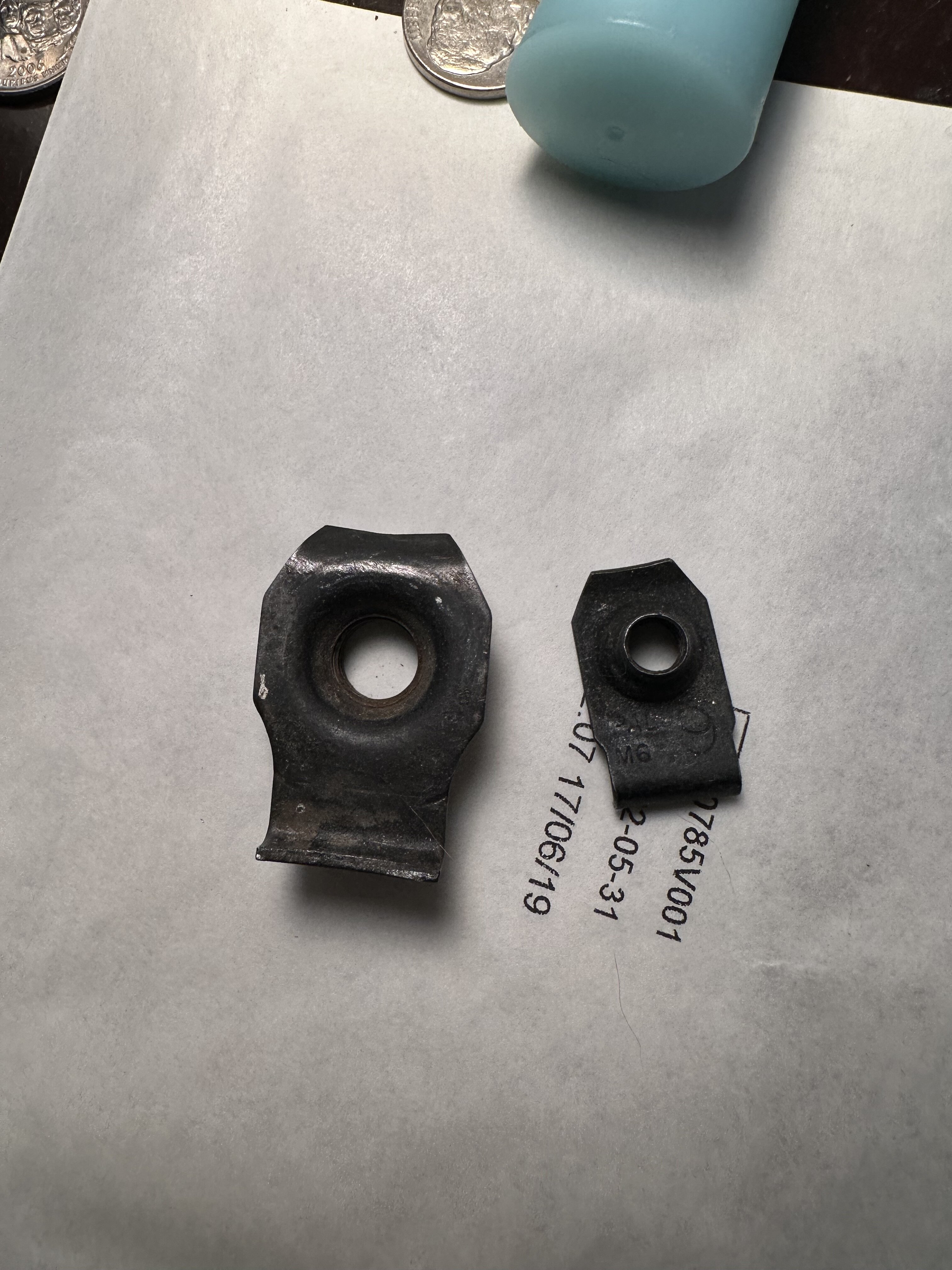

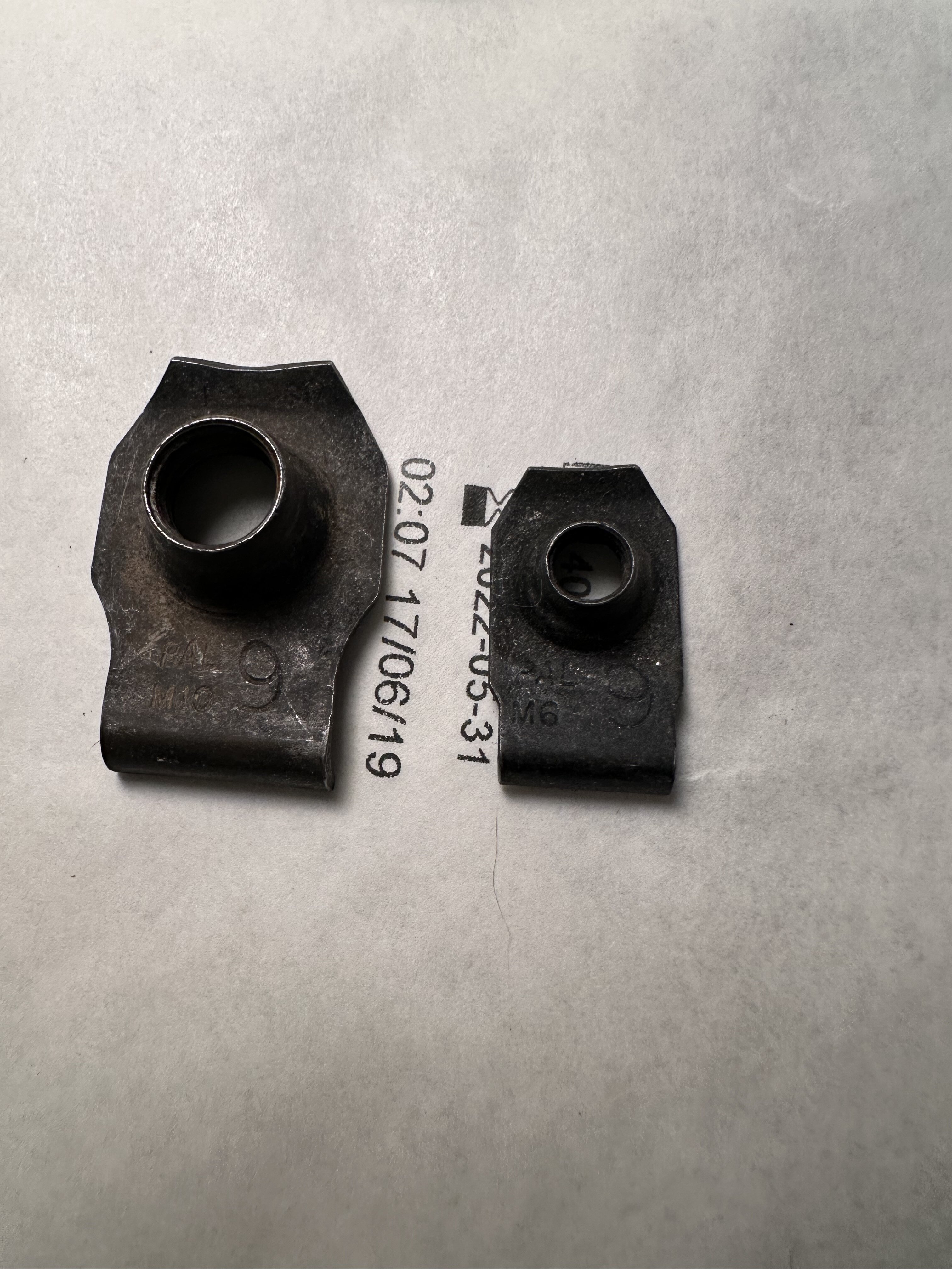

Do you know where to find the u nut that fits a 15mm bolt? I can’t seem to find them anywhere. I can find the ones that fit a 10mm everywhere. In the picture it’s the one on the left.
