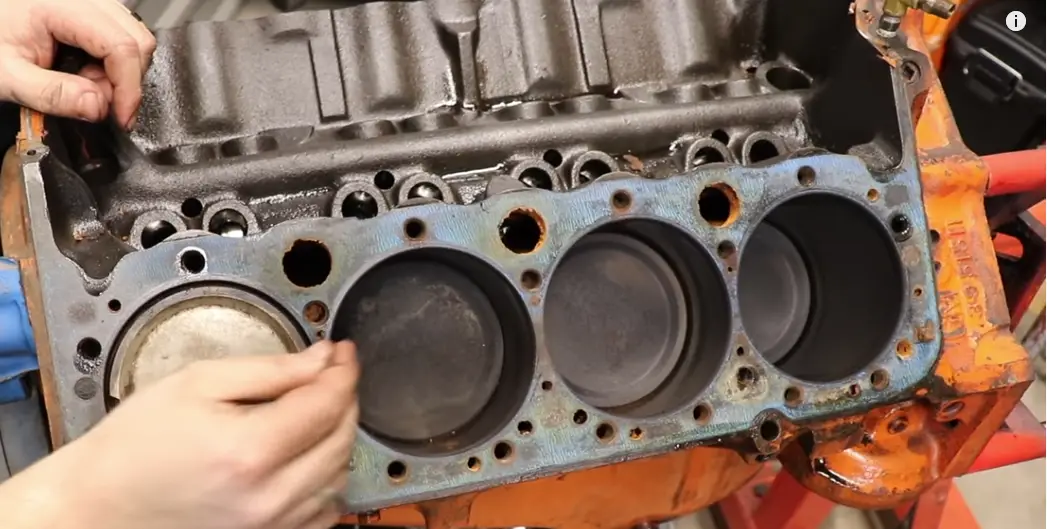

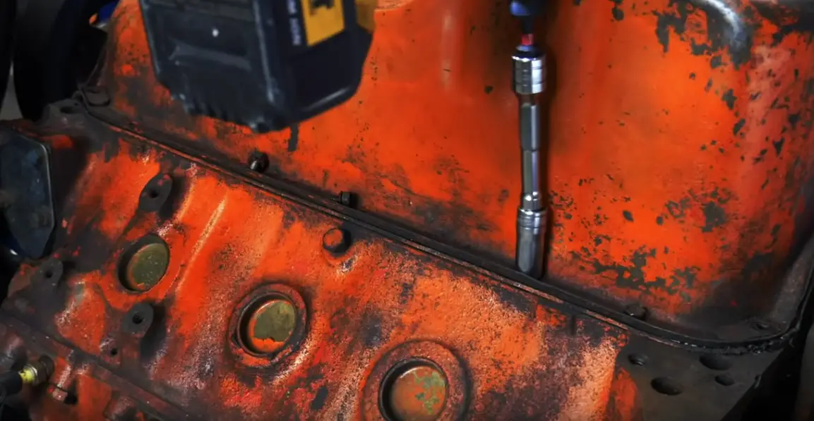

The one on the right looks like the 400 I already have. '509' cast into the cylinder wall and the missing middle freeze plugs. What's the one on the left? Sorry, I didn't take a second photo. The mystery motor has three oil plugs above the cam shaft, while the familar one has two.
Thanks for your advice.

I thought middle freeze plugs were supposed to indicate a 4 bolt 400 block. I know none of my 350's have had them. But both of those engines In the picture appear to have splayed caps, thought you needed to start with a 2 bolt block for those? I've got lots to learn. Lol

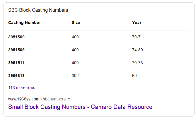

Of all places, YouTube provided the answer.
The one on the left is a 511 block, 70-73.
Other places suggest that the later castings have more material on the main webs, so the 511 may not be the better of the two.
I haven't committed. If they get bought, then the decision was made for me.

Years ago I pulled the 400-2 barrel out of my father's 71 Impala. It was a 3 core-plug, 2 bolt block.

Yes 3 core plug blocks were the early 400’s. That’s how all the street guys knew how to identify a 400. That and the balancer were pretty big giveaways for people trying to pass them off as little motors. I had a 406 in my 79 Malibu in the early 90’s and none of the young guys knew what it was.

I have a late 72 400 block that has 3 freeze plugs per side and is a 2 bolt block. Most casual observers do not realize that the 2 bolt 400's have the 3 center main caps that are as wide as the 4 bolt caps. As such, the registers in the block are already the correct width. The smaller 2 bolt small blocks have narrow main caps on the center 3 mains which requires machining to fit 4 bolt caps.
