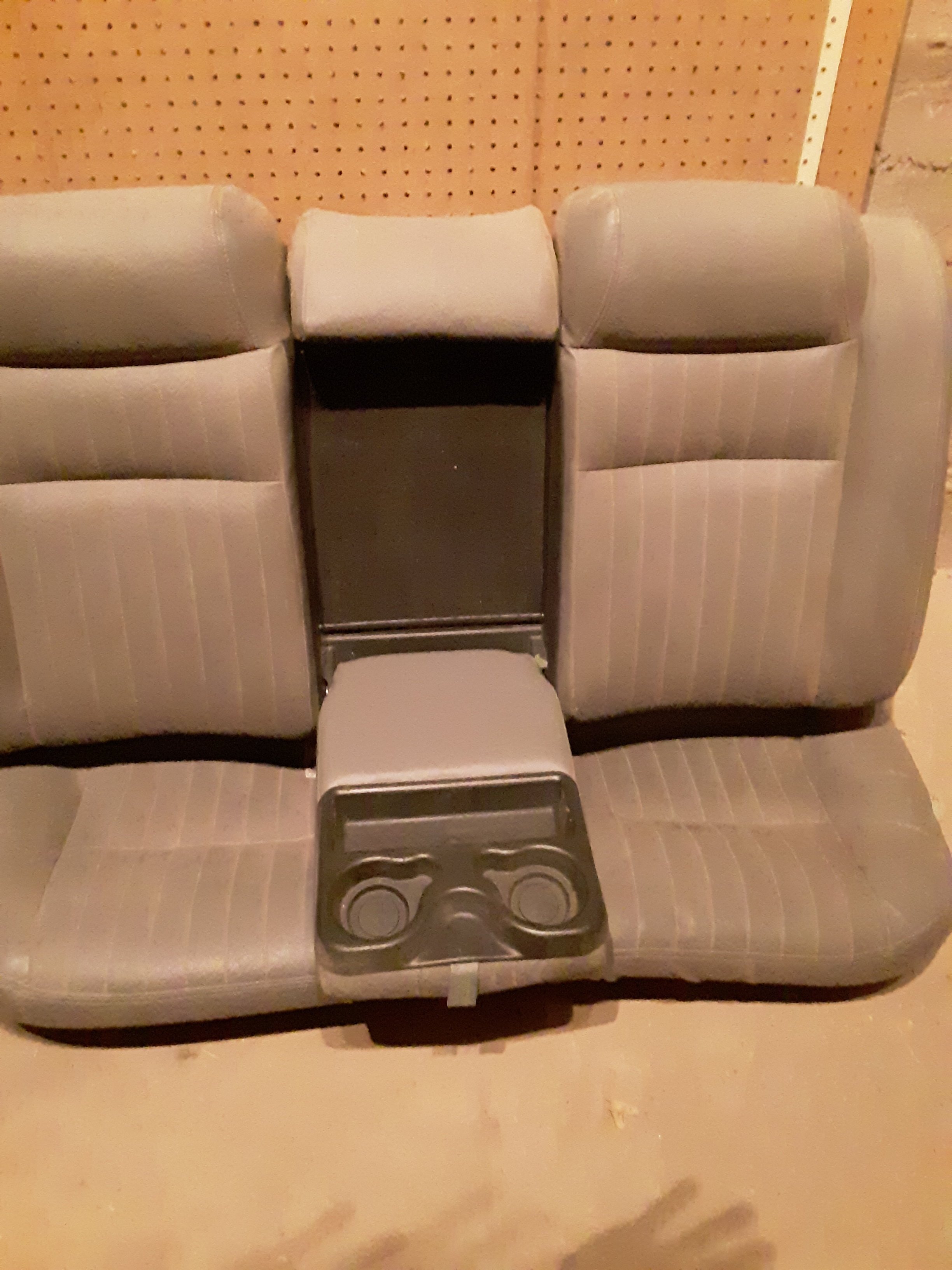

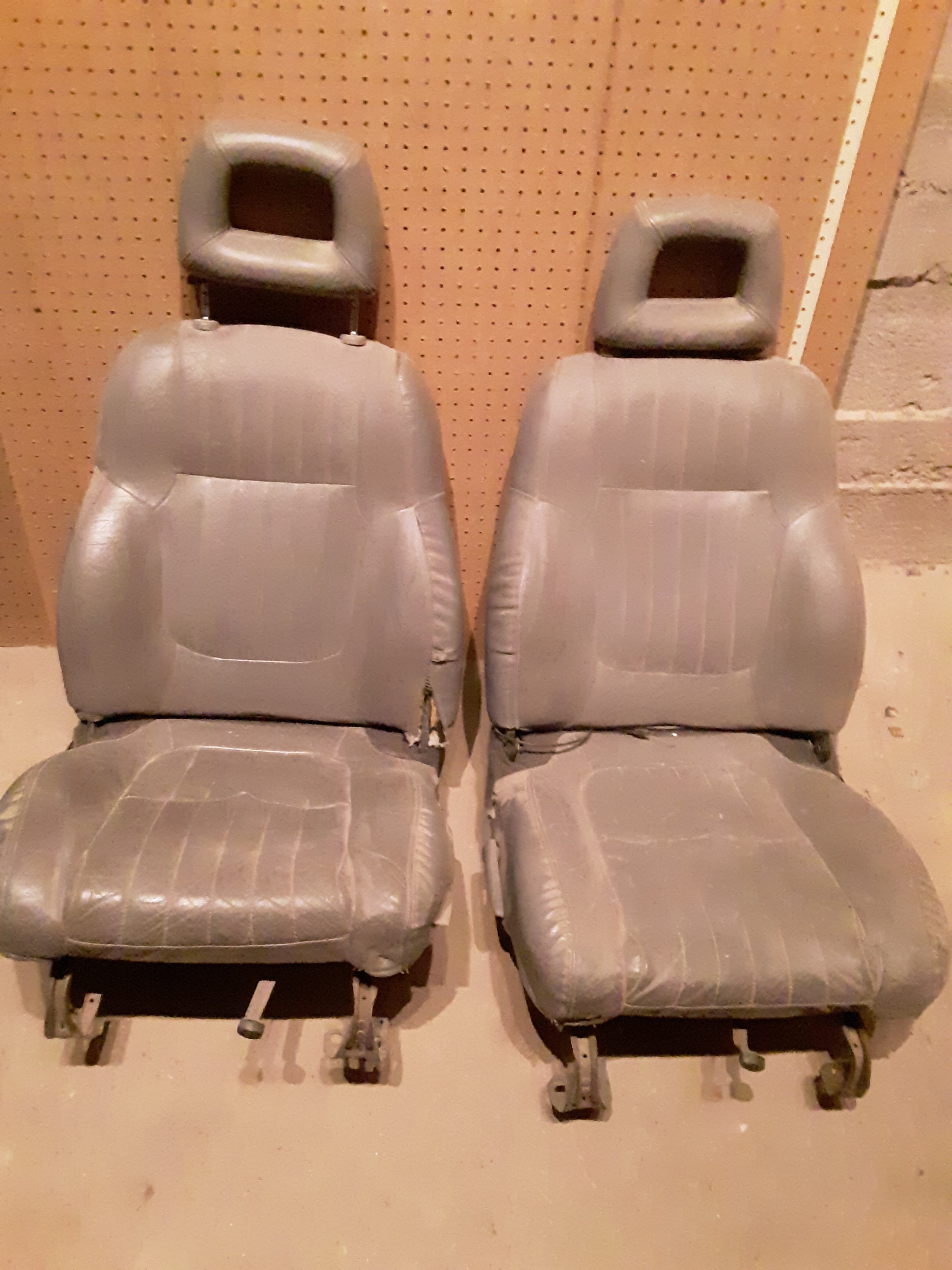

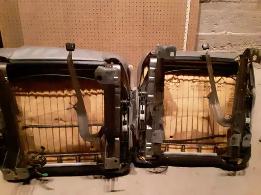

Measure 14 in between and bolt up track...same for impala,mc,etc of newer years.
How did you get the G body seat tracks to bolt to the Grand Prix seats? Did you use spacers between the tracks and the seats? I ask because the bottom of the Grand Prix seats are flat, and the top of the G body seat tracks are curved.
