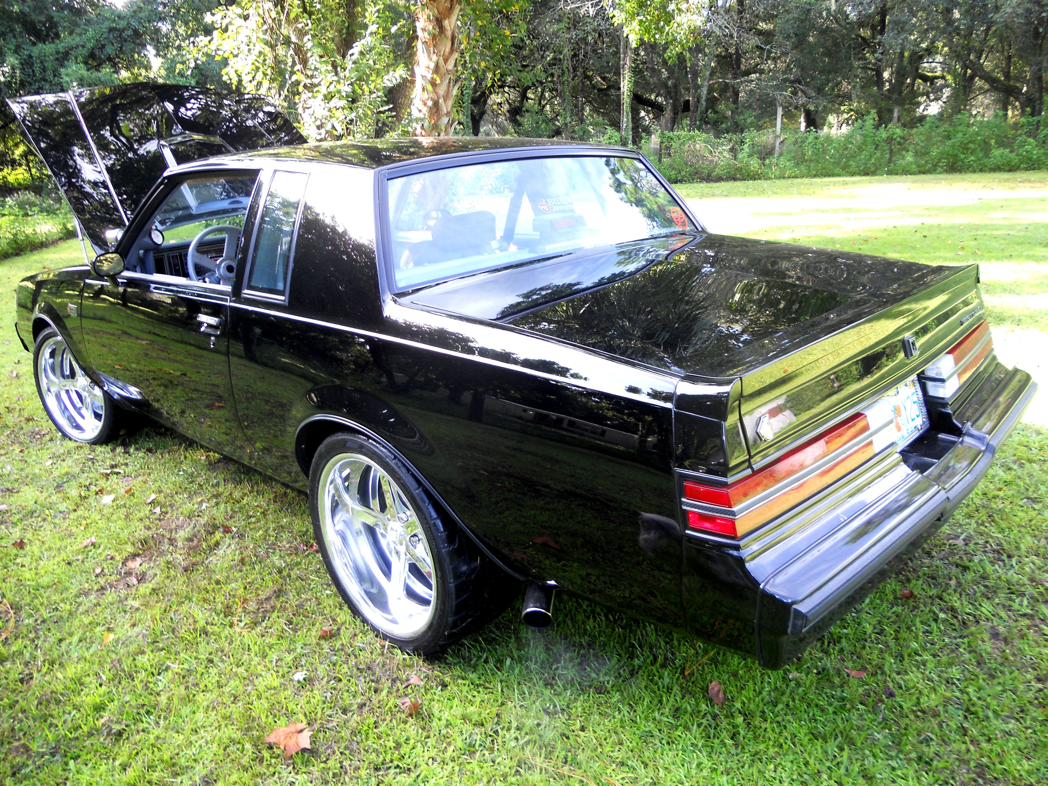

I used Nason synthetic enamel for years with Nason Qwik-cure hardener. Works great. I think you can still get the black. It's about $90 a gallon. Finishmaster sells it. Polishes out like the best base coat clear coat.
If you can't get the synthetic enamel, acrylic urethane is pretty similar, and not too much more expensive. I quit PPG years ago because it's just plain overpriced. By the way, I painted my GN 15 years ago with nason synthetic enamel, and took that photo yesterday. ;)
Very nice GN, your paint looks like 2 stage to me. I agree with the Nason brand. I used Nason Urethane Black on my Cutlass, I believe it was 400-01 in the mid 90s. Layed down pretty easy and buffed out to a deep gloss. Not sure if they even make it anymore but it’s a good quality durable paint for the price. Paint still looked good when I repainted the car this year with DBC 9700.
