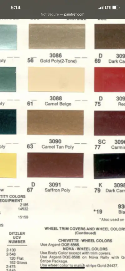

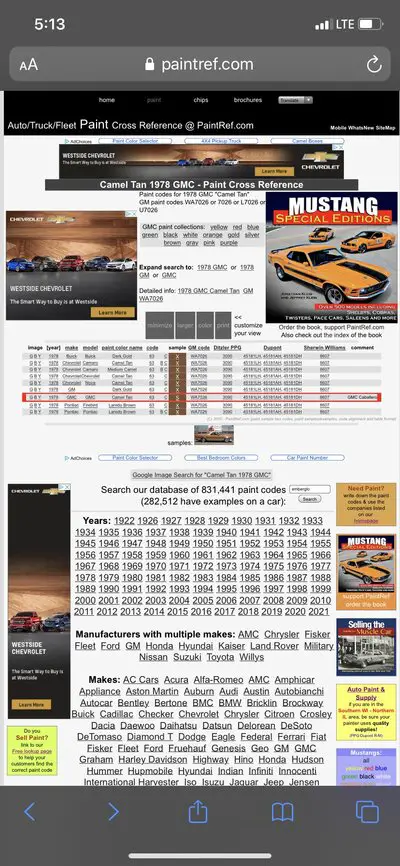

I figured the paint would be off from the color code and the agreed paint. It’s more for the valve covers and maybe the rims. Odds and ends. Oh and for a model car I have to match.For the age of our cars you'll have to have it custom mixed as Dupli-Color makes them for most current production colors. If you haven't been told or not sure where to look for the color code, look on the drivers side of the cowl for the Fisher plate that has two number code in the middle. It'll be xxL & xxU for lower & upper colors (done this way for both solid & two tone paint jobs.) And a technical note, the smaller the mix batch the more likely color match could be off.
I’ll look at the website to see what I find. I’ll also search a model site to see if they have a similar color or see if I can find someone to mix me up something. Thanks.Looks like you've found everything you need to match your color. WA7026 is the only number you need. Take it to any quality paint store, tell them what you want, and they should be able to hook you up.
