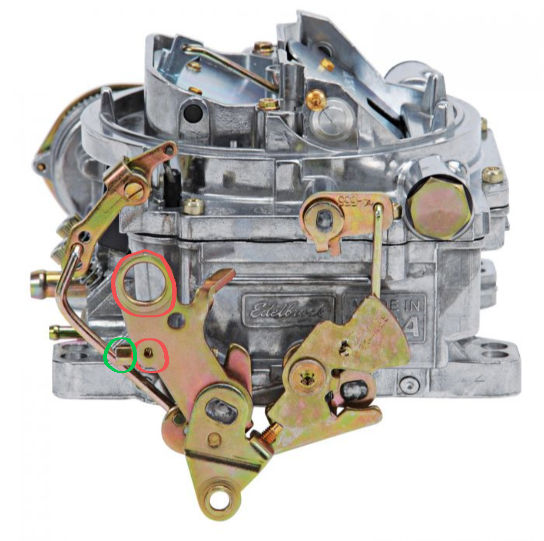

My throttle cable keeps sticking and staying stuck after acceleration and taking my foot off of the gas pedal.
I have to use my hand to press it back down into the correct position to keep it from revving too high in Park...
I have new return springs at the front of the engine to pull the carburetor throttle linkage place...the smaller spring goes in the fatter spring and they both connect from the return bracket at the front of the manifold to the carburetor throttle linkage...but I only use the smaller spring because the fat spring gets caught on the idle screw when I let off the gas pedal. I assume the smaller spring isn't strong enough to pull against the too tight throttle cable...
New carburetor so I don't see how it could be the carburetor, unless the butterflies are getting caught at the intake, but this issue doesn't happen until I connect my throttle cable to the carburetor throttle linkage...
I'm told while adjusting the throttle cable, to pull the cable towards the front of the motor until it stops, adjust the bracket until it reaches the carburetor throttle linkage, and it should be "piano string tight" when I'm finished...
But it seems to be pulling the carburetor throttle linkage back and keeping it there after I accelerate and left off the gas pedal...
At idle, my RPMs are 750 but if I cruise and park it, the RPMs are at 1,000-1,200 RPMs and if I shut the engine off during that high idle, the engine stumbles to shut down for a couple of seconds instead of just shutting off...(which could also be caused by my 9 PSI way too high fuel pump pressure...)
I strongly believe my throttle is misadjusted and it's too tight...Am I adjusting this throttle cable correctly or is it what's causing the "sticky" throttle linkage ?
