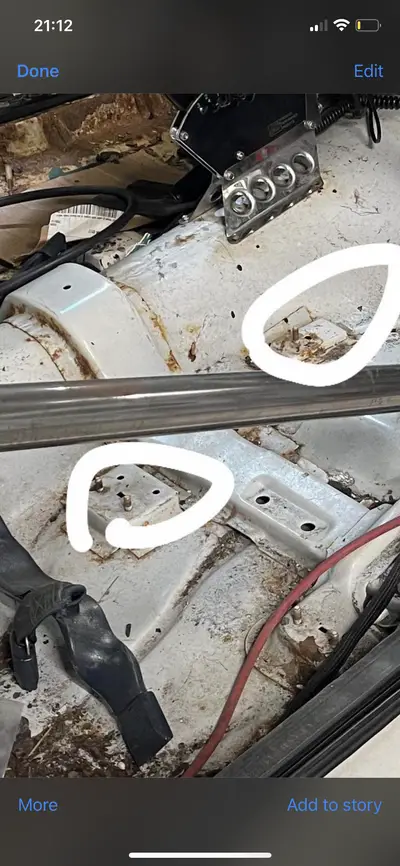

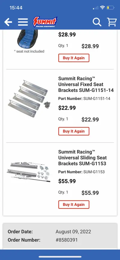

Hello,
I have the summit racing seats with universal brackets that come with it they seem to short to fit my bench seat mounting points. What brackets has everyone used and sadly I threw away my bucket se

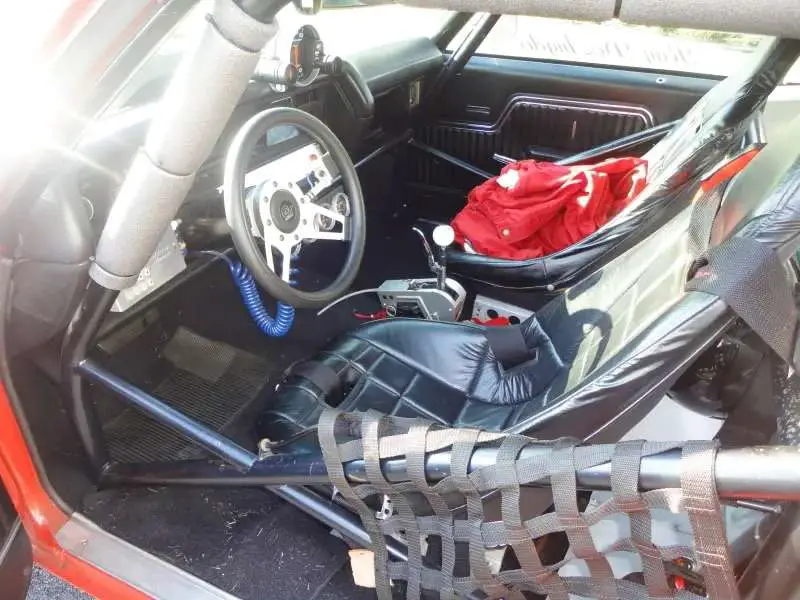

You’ll need to make your own mounts for just about any non Gbody seat you want to use. I bolted 1/4” flat stock to the original mounts on the floor and bolted my seats to the flat stock. I used some 1/4” angle to tie the rear of the flat stock together.
