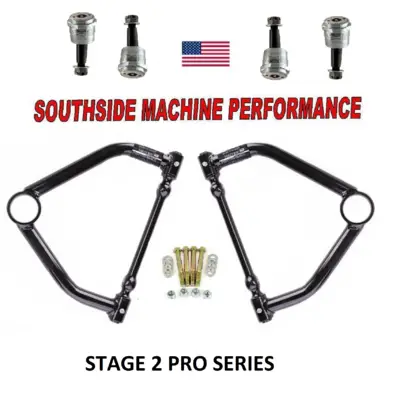

I am trying to order the last of my suspension parts to build my frame. I already have spohn arms for everything except the front uppers what I am trying to get ordered asap, I am using blazer spindles with C5 brakes installed. I am getting hung up on the upper arms and ball joint combo. My buddy had a monte SS with the SC&C AFX spindles, stock lower control arm and the SC&C upper arms and I can honestly say that, that car drove like it was riding on rails! But the spindles and upper arm combo alone is 2000 bucks. So to my understanding, and maybe I am incorrect. The AFX spindles shine because they have added 1.4” of height to them to correct geometry issues while lowering the car 7/8”. So from the research I have done I have found that you can order a .9” taller lower ball joint and the .5 upper is commonly used to help out these issues. If I am understanding this right, .9 lower ball joint is roughly the 7/8 that the AFX says to lower the car and then add the .5 upper and we get to the same or very similar place without buying the AFX spindles? If this theory is correct, the ball joint combo alone would be a drastic improvement on handling. The tall lower helps correct the bump steer and the combo of adding 1.4 total with ball joints helps correct the camber curve.
The second part I am confused about, both UMI and Spohn offer a upper control arm for standard spindle and tall spindles. By using taller ball joints, you are doing essentially the same thing as swapping to a tall spindle right? So do you need to use the upper arms for a tall spindle?
