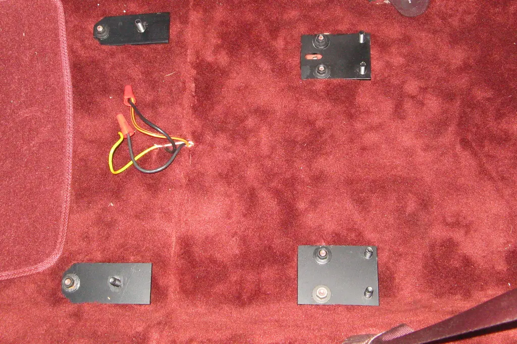

I made brackets for my Regal to relocate my seats farther back out of 1/4" plate and grade 8 bolts.

RIP out the front seat and sit in the back. Lol I am also tall 6'7" and have modified many seats. I did the same thing that 565bbchevy did. Easy mod.
