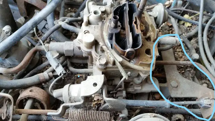

Looking ahead to my trans swap and wondered if the cable bracket on the intake is different between a TH200 and a TH350 equipped car?
Motor will stay a SBO, carb will go from a dualjet to a Quadrajet.
The TH350 has a kickdown cable on it from the donor 3.8 Monte so I'll assume that will need to be changed also.
Stock bracket is like this one - Dualjet and TH200: 20150920_130405_LI.jpg

My 305 SBC Qjet/TH200 bracket worked fine when I swapped in a TH350. Not sure on your cable, but might just need adjustment.

They are actually the same cable. Use the bracket that fits the qqjet. The one in the pic isn't it

For a TH350 swap, as long as the kick down cable will reach, it will work. I used the bracket with the stock 260 and the 2004R and the geometry was wrong. That bracket should bolt on top of the Qjet. Is the throttle cable on the outside or inside on your Qjet, like that Dualjet? I have seen both.

The bracket mounts under the back 2 q jet bolts and has 1 locating pin that has a matching hole in the qjet. I don't think they are model specific but I'm not 100% on that fact. It will also mount the throttle cable

To answer the above, throttle cable connects on the inside on the Q-jet I have.
