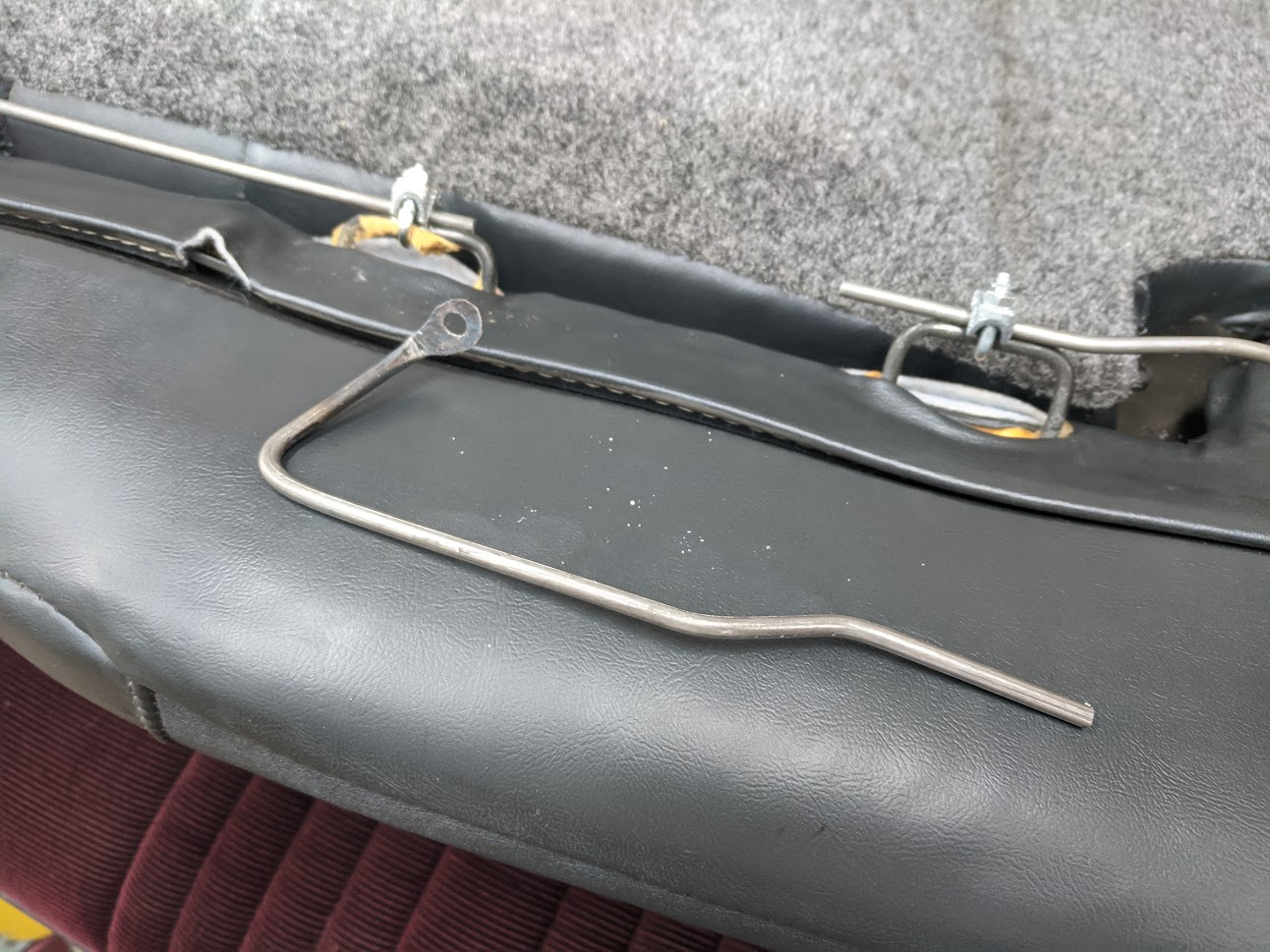

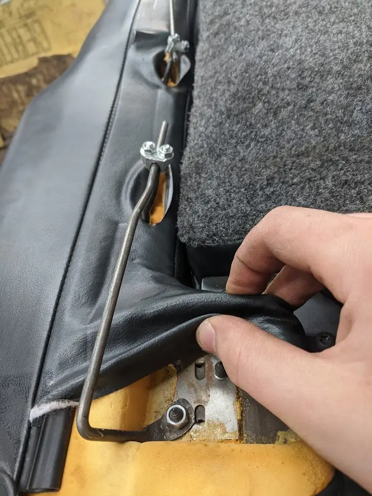

Rear seat folds down.
Rear seat upper cushion needs some brackets up top to latch into the G body hooks

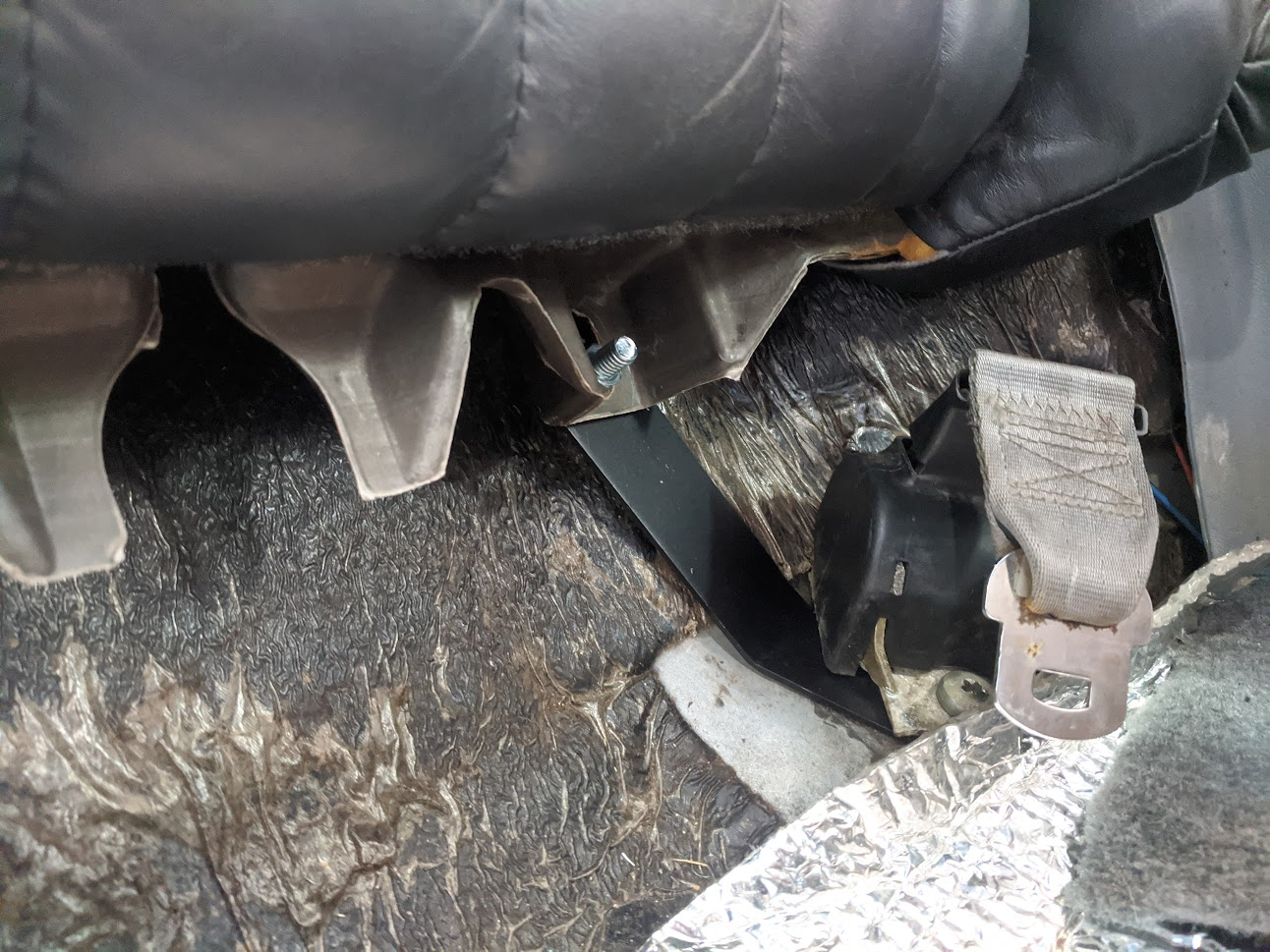

Lower cushion gets a small tab.

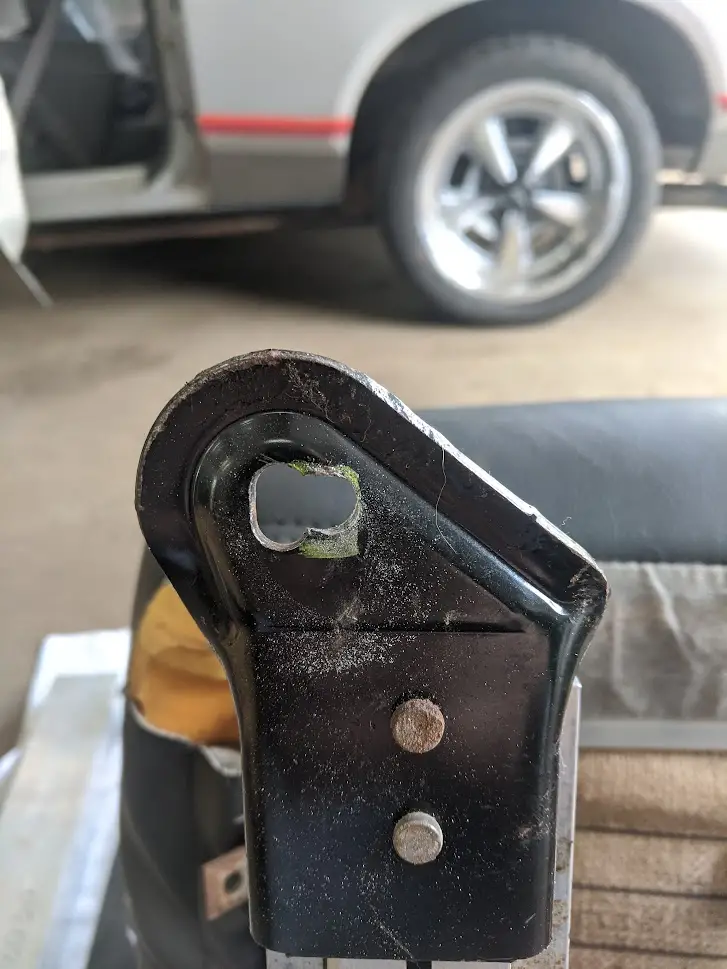

Front seats get a small bracket on the rear
Front bracket on front seats just need a hole slotted

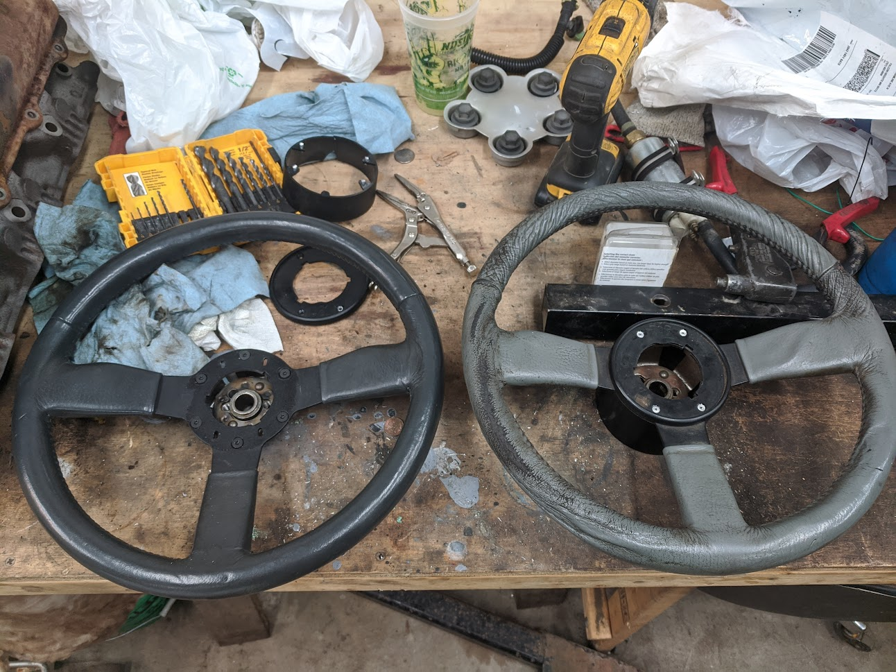

84-88 fiero or Fbird steering wheels are the same as GP wheels, just have to swap the bracket/standoff.

Thank you for sharing this info. The seats look really good, and I like how the rear seat folds. What size of metal channel did you use on the rear legs of the front seats?

1.5x3 if I recall correctly
