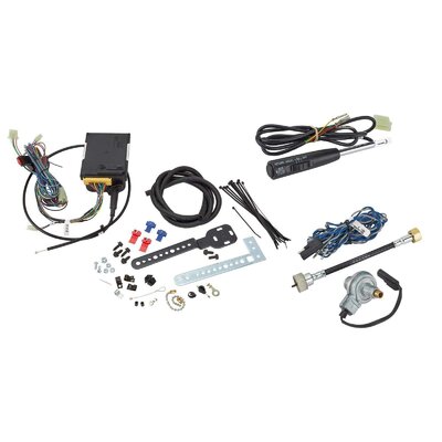

Thinking of adding an aftermarket cruise control set up. Anyone have any experience with them?

I have been looking at the Dakota Digital CRS-3000-1 or the Ididit 3100020000. Both are self contained and do not require vacuum. I like the speed sensor that can mount inline in the speedometer cable; that is a nice feature as I have several G body cables that are 2 piece and it can go in between them. They both offer turn signal levers with controls that have an "OEM" look to them.
Does anyone have any experience with either of these set ups? Just looking for some insight.
