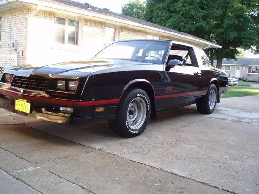

I run a 245-60r-15 on a 15 x 8 Corvette Rally 4.0 back space and they just lightly touch the sway bar at full lock on my 88 SS. The factory 15 x 7 N90 wheels cleared using the same tire with no problem.
