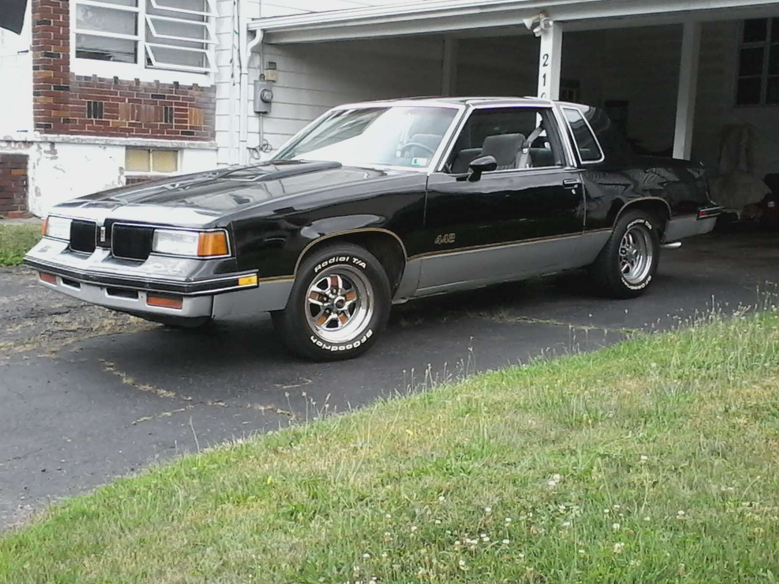

215/65/15 is what came stock on the performance g bodys. 235/60/15 is a good replacement for the 215's , same height 26" just a bit wider. 215/70/15 should also fit just fine, about 27" tall. I had 215/70/15 's on my 81 GP for years and had no clearance problems.

Here is a couple pics. The GP has the 215/70/15 and the 442 has 215/65/15.
