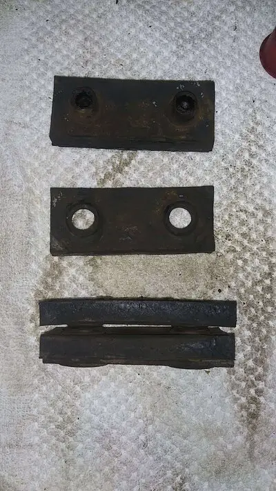

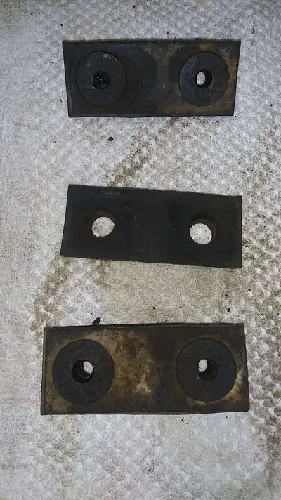

Morning everyone. Where can I get replacements of these for my crossmember. They smush in-between it and the frame where it bolts the car is a 1979. Originally a th200 now has a th350 in the car with the Buick V6.
I could also use photos of how it went and bolted up underneath if anyone has some. The spare crossmember i was going to use... the mounting holes on the sides are different than mine. (Smaller) probably due to it being from a SBC/350 car and a 78.
Any help appreciated. Trans is in the car but need to finish this up.

I usually make replacements out of steel of equal thickness just to keep the trans at the factory angle, you will still have a rubber/poly trans mount to absorb vibrations and allow some movement.

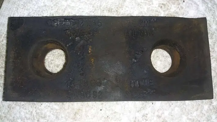

Need 2 of these (p/n 375726):
You sure you want NOS at those prices?
And 4 of these:
457908 insulator (white) was replaced with 459092 (blue) in 1982.

Insulator sits on frame, then transmission support, insulator #2, then retainer (the part with the pegs) goes through there. Then a bolt goes up from underneath the frame bolt holes and a nut retains the top of the bolt. That's what it shows in the parts information.
