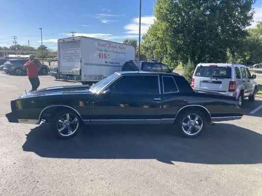

Monte Carlo; I'm not amused with how it sits right now and hate the float.
I read a thread on here about how bad UMI lowering springs are. Is that still true/any recent good experiences with UMI lowering springs? Should I go BMR or Moog instead?
I bought the $299 kit, but am returning them tomorrow.
Have Bilstein performance shocks all around.
Iron Head 350, AC up front. So a little heavier in the front than stock.

Nevermind, Ramey from UMI PMed me and summarized where they are at. They make good stuff, but trial and error is sometimes needed. Some of you slapped 2" umi lowering springs are and it was perfect. I have an iron block v8 swapped in and AC so I'm helping that reduces my chances of the front "sitting high".
Here's what I have now stock that I'm trying to lower 2":

I put 2" UMI springs on my 383 aluminum headed Monte Carlo SS and it was fine. I believe that kit came with UMI shocks as well. This car has the front and rear bracing.
by comparison, I put BMR 1.5" drop springs on my Regal with the Bilstein shocks in their kit and I don't like the ride as much. To be fair, I may have body mount and frame issues. This car doesn't have front and rear bracing yet.
Both cars still have the OG control arms.
