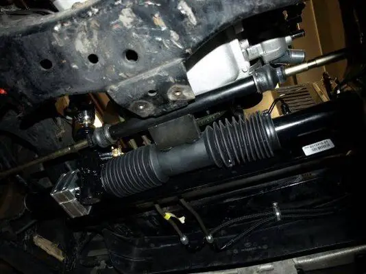

Rack and Pinion - Power - 1978-88 GM G-Body - 262-400 - Long Water Pump - 8012400-01
The G-body kit is a front steer rack and is bolted to a one piece bracket that mounts to the inside of your frame rails. It utilizes the same bolt holes that your steering box and idler arm were attached to. The kit was designed to match the stock pivot points on the vehicle which will not only...www.unisteer.com
So I am guessing you can't use your jounce bars on there?I have it installed on my monte carlo ss no issues with ls3 swap.
That's what it looks like. Sacifice stiffness for better steering.So I am guessing you can't use your jounce bars on there?
No they don't clear rack. But the bracket is a solid piece that bolts to both sides of the frame that stiffen the front frame.So I am guessing you can't use your jounce bars on there?
