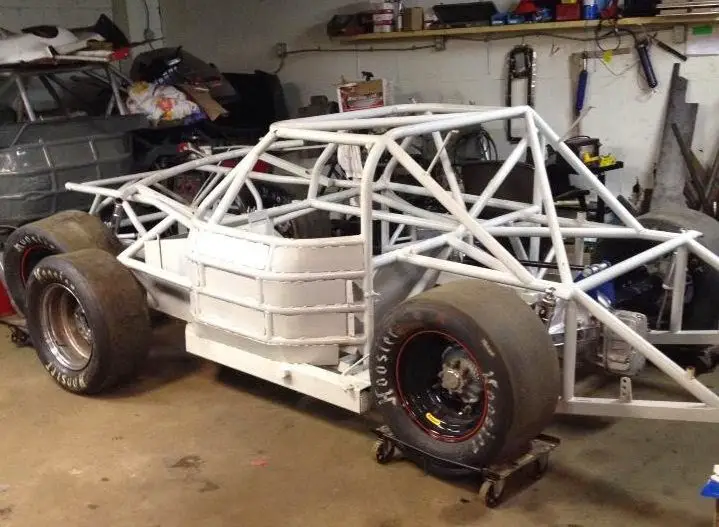

Again , to the novice the video you posted probably seems reasonable , in the real world you never stop a weld in a radius ! And again im talking about when a weld really matters and has to be right !
this pro late model circle track car was made in the real world, there were places that we had issues getting the weld in and most of it was welded by a very experienced millwright. There was areas where we could not get a continuous weld in a radius and he nor any of other chassis builders who came to look at the project had any issue with the welds...
Like i said previously it can be done in certain situations , but it is not desirable ! Any welder will tell you that . And the fact that you had a good experienced welder working on your project helped more than you realize. You see when you do that for a living your constantly looking at all the potential problems 3 welds ahead of being made , thats what a experienced welder does ! He also knows all the problem areas and how to do a good work around for the project hes working on . Thats a good looking build !
