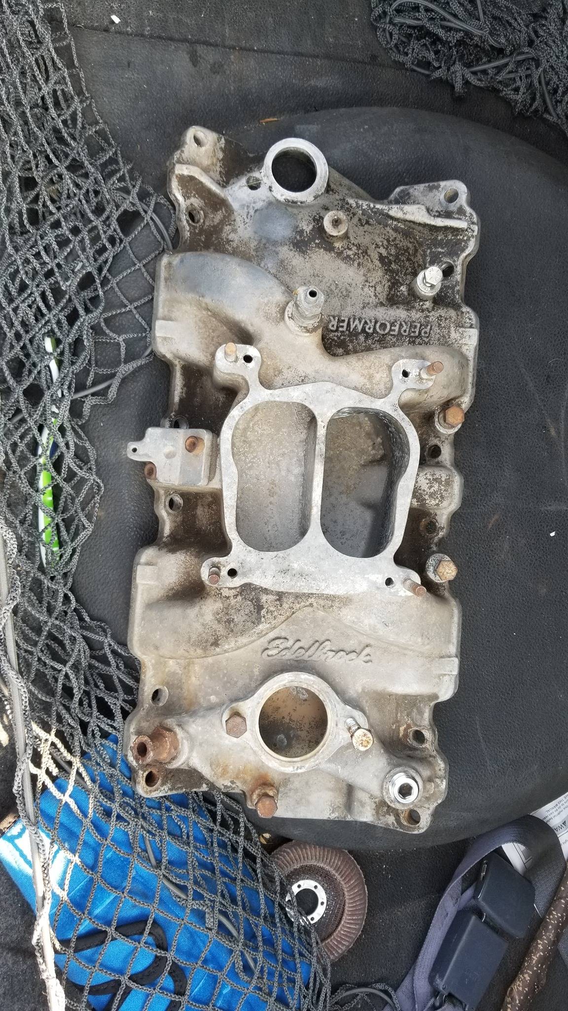

Little something I found today while looking to spend money..lol Hard to find these for under 125 around here ,,Got it for the low amount of money I wanted to pay. Knew one would show up for the price I wanted if I just waited. View attachment 180531
