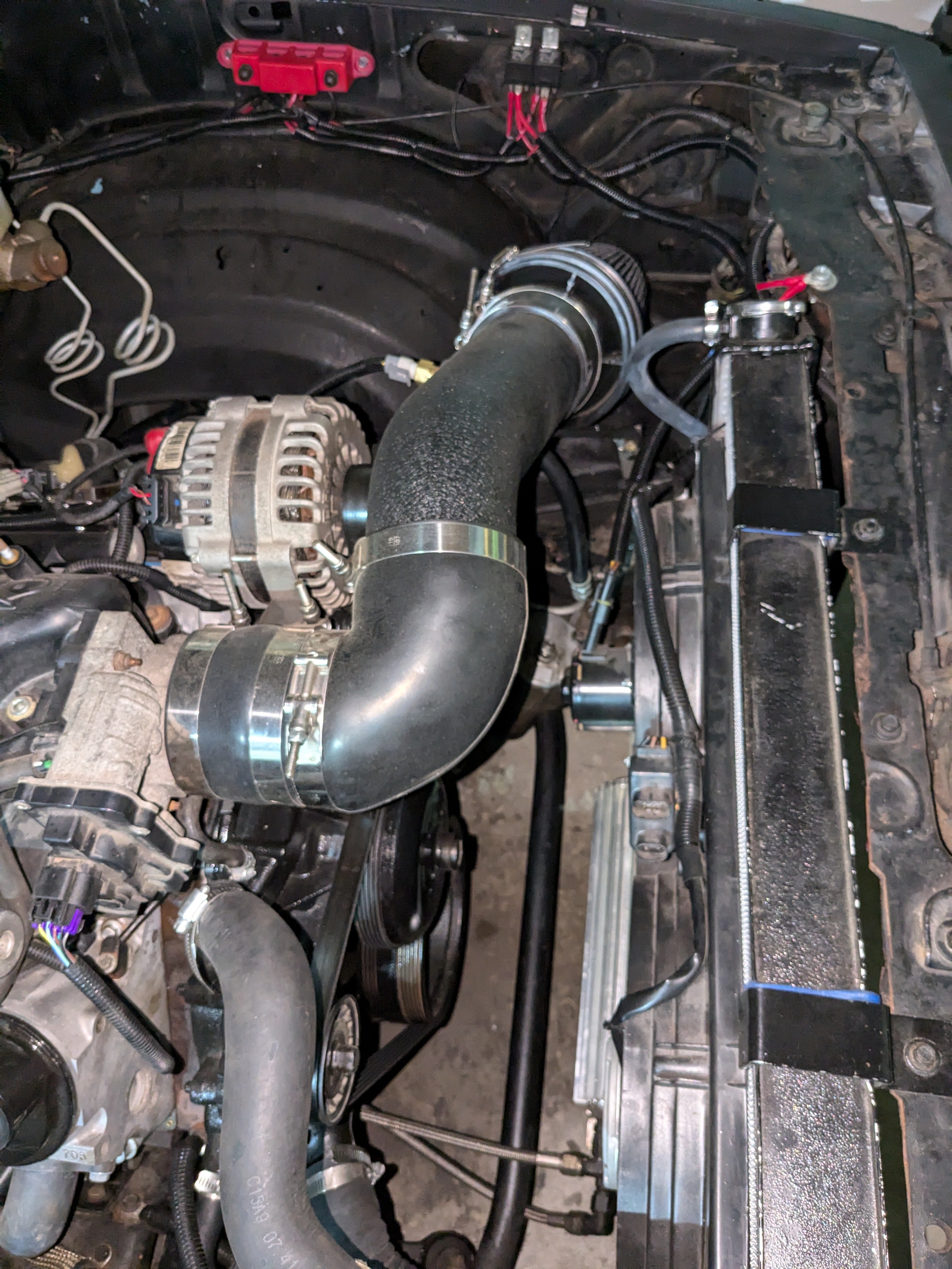

I'm mounted mine on the passenger side. I used a piece of 4-in used diesel exhaust pipe. Cut out the section I needed THAT had the bend I wanted. Cleaned it, painted it and mounted my mass airflow sensor to it. Bought a 45° elbow off eBay and used an AEM filter. I then made a cold air box out of aluminum tread plate. I'm going to cap it with a piece of lexan just haven't done that yet. I didn't want to be sucking iN hot radiator air.
