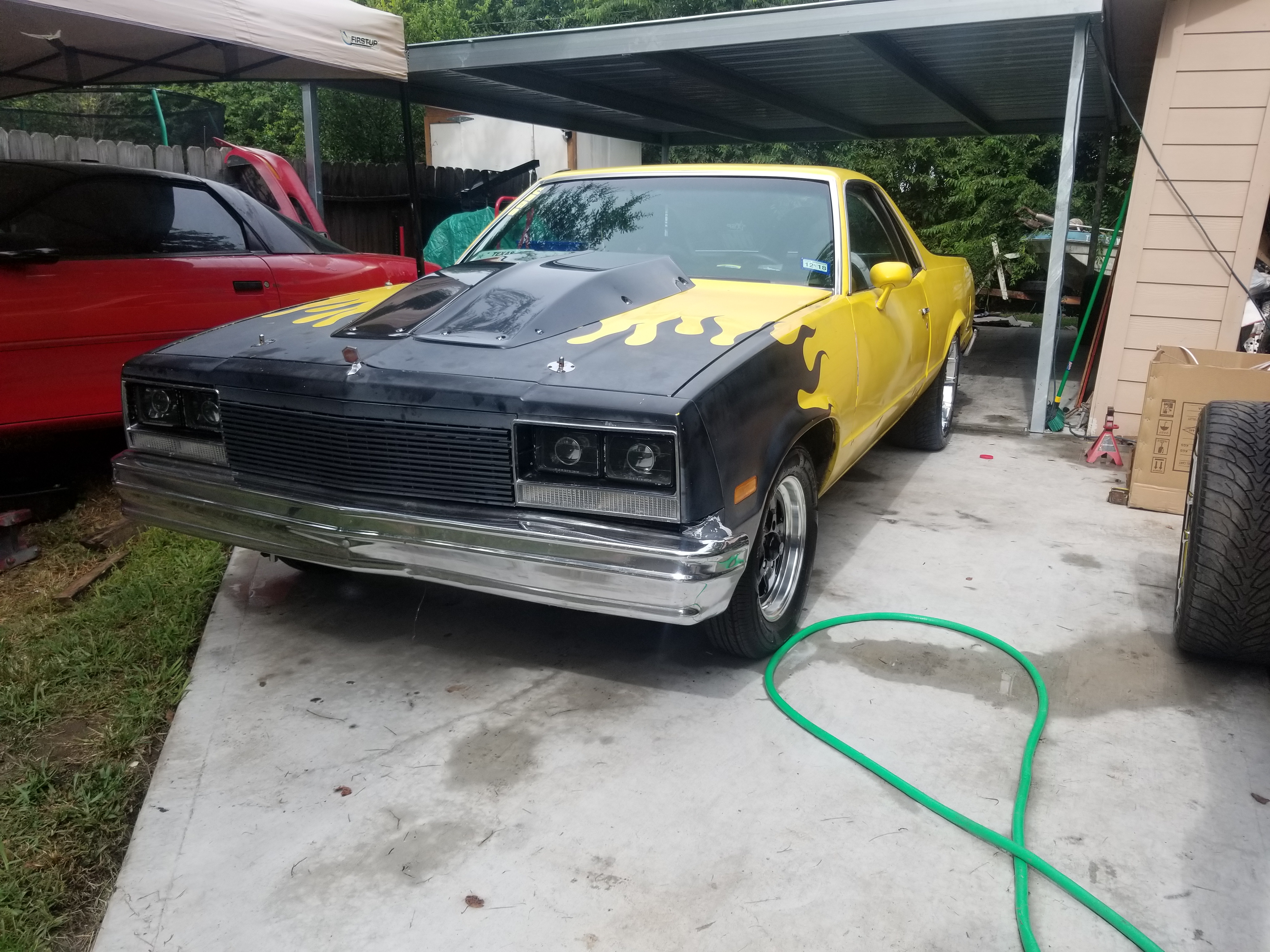

So do you recommend any upgrades to the rear I'm doing c clip eleminatos, gears, CRUSH ring elminators, and some axles and weld the axle tubes and griddle im trying run low 7's in 1/8 with a 175 shot around 675 horsepowerIt is 2.5" wider than the G body, you'll need conversion uppers and a joint on the axle side of ther lower to pick up the angle discrepancy. I got my conversion uppers and a lowers with the Roto joint on the axle end for my GP from UMI. The spring purches are on the front of the axle complared to the G body which is in upgrade the center. I left them in the front and it didn't seem to bother anything. If that rear is an 8.2 and it has a Eaton posi there was a bulletin on those, the thrust washer on the pinion gears prematuely wore due to the metal they used. Mine were paper thin but the kits with the gears and thrust washers are still available.
So do you recommend any upgrades to the rear I'm doing c clip eleminatos, gears, CRUSH ring elminators, and some axles and weld the axle tubes and griddle and a set of 4.11 or 4.56 im trying run low 7's or 6's in 1/8 with a 175 shot around 675 horsepower
It's pancaked already?So do you recommend any upgrades to the rear I'm doing c clip eleminatos, gears, CRUSH ring elminators, and some axles and weld the axle tubes and griddle im trying run low 7's in 1/8 with a 175 shot around 675 horsepower
