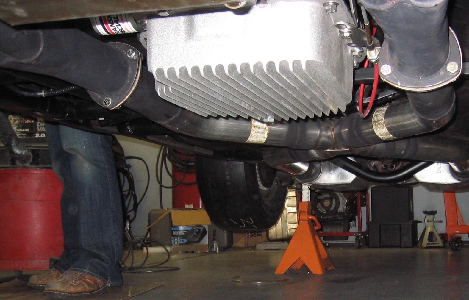

Being on a tight budget why would you try building a 383 - you can get plenty of power out of that 350 - yes your going to have to do something w/ that cross member, I made my own. I would think twice about the Pipes system the bang for the buck just isn't there. Get your truck running and play w/ the Monte when $$ are available.

If your car is registered somewhere without emissions testing, you can run dual exhaust without changing the crossmember, but you'll have to get some help from an exhaust shop bending a tube to go under the crossmember on the driver's side (and watching out for speed bumps) or making a custom S-bend in the stock location joined to shorty headers to bring both pipes over to the passenger side. If you do the latter, you could also use a Dynomax (or equivalent) kit for a Monte SS / Buick GN that has a single intermediate pipe and dual mufflers / tailpipes or a dual outlet muffler in the stock locations. The advantage with the latter idea is that it is a 'cat-back' system, and if you find yourself transferred to emissions territory, you can still run a high-flow cat. Edelbrock used to sell a TES system for the Monte Carlo, but I think it's discontinued, but you may be able to find one used via the Forum.
