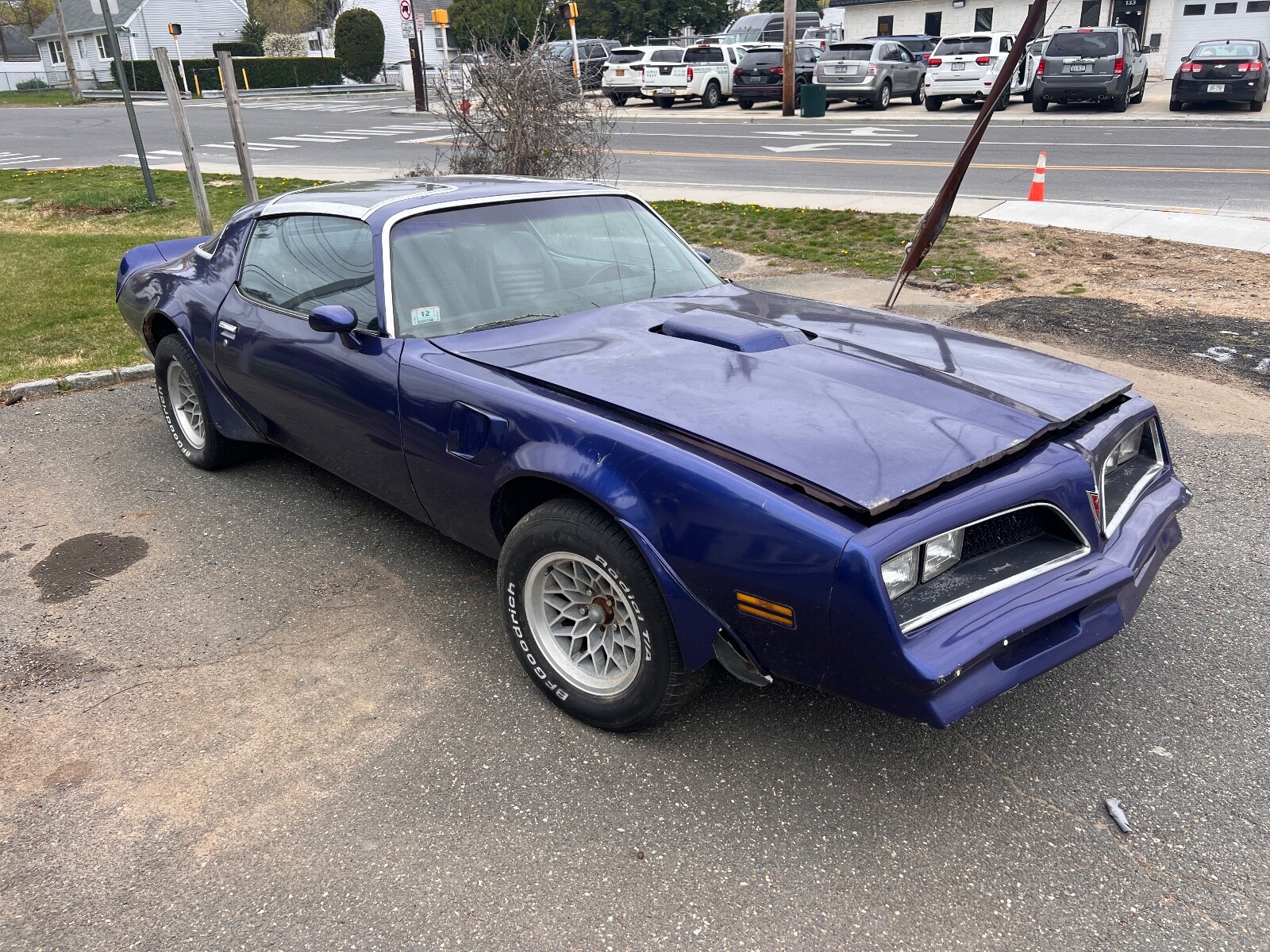

Not bad as a daily driver on cruise weekends. A little rough for a starting project for restoration with all the rust around the trunk opening. The rest is typical rust in the typical places. But whomever purchases needs to be very careful and check the spring hangers those are where they fail and that's going to be your biggest issue. If those are good, then Goodmark has all your sheet metal.
As far as Hurst t-tops being rare..., not really
The rarest is the American classic which is what I have on mine, and the biggest problem with that is you can no longer get the gaskets and the seals to keep it from leaking. 78 mostly were Hurst Tops, it was after that where they became Fisher t-tops. 1979 was a mix, and most of your 80 and after were Fisher Body. The nice thing about that is there are still roof cuts available but you're going to pay a good price for one. Having a true TA with the actual Pontiac 400 that is a definite plus. If the 400 is factory, then this was an Ohio car. Van Nuys California was the Oldsmobile 403.
This looks like a WS6 package, yet that is still drum brakes in the rear which is also what you see with your master cylinder. That's a disc drum master cylinder. Everything else is fairly fixable and it looks fairly square, has all its glass and the frame doesn't look too bad. You have one area where you have a pinch weld that's splitting but that can be fixed and resealed.
$7000 in 2025? I'm not sure. I would say more around 5,000. If this was 2010-2011 you wouldn't even touch that car 7,000 for a rusty hulk, but the bottom dropped out after 2009 because of the housing crisis. Yet, on the Trans Am they were still way overvalued at that time.
Looking at just the rust abatement, and that's assuming it has a good drive line, $15, 000 to $25,000 depending on what shop you take it too. Right before I left Indiana to come to Arizona after returning from Iraq, I helped a guy do a Toyota Land cruiser and for all the Midwest rust, the total bill on just getting it into primer was something like $18,000.
If you could get it for $5,000 that would be fair and it's something that you can work on even with spending some cash on the rust issue you still be close to being even or maybe positive on return on investment.
