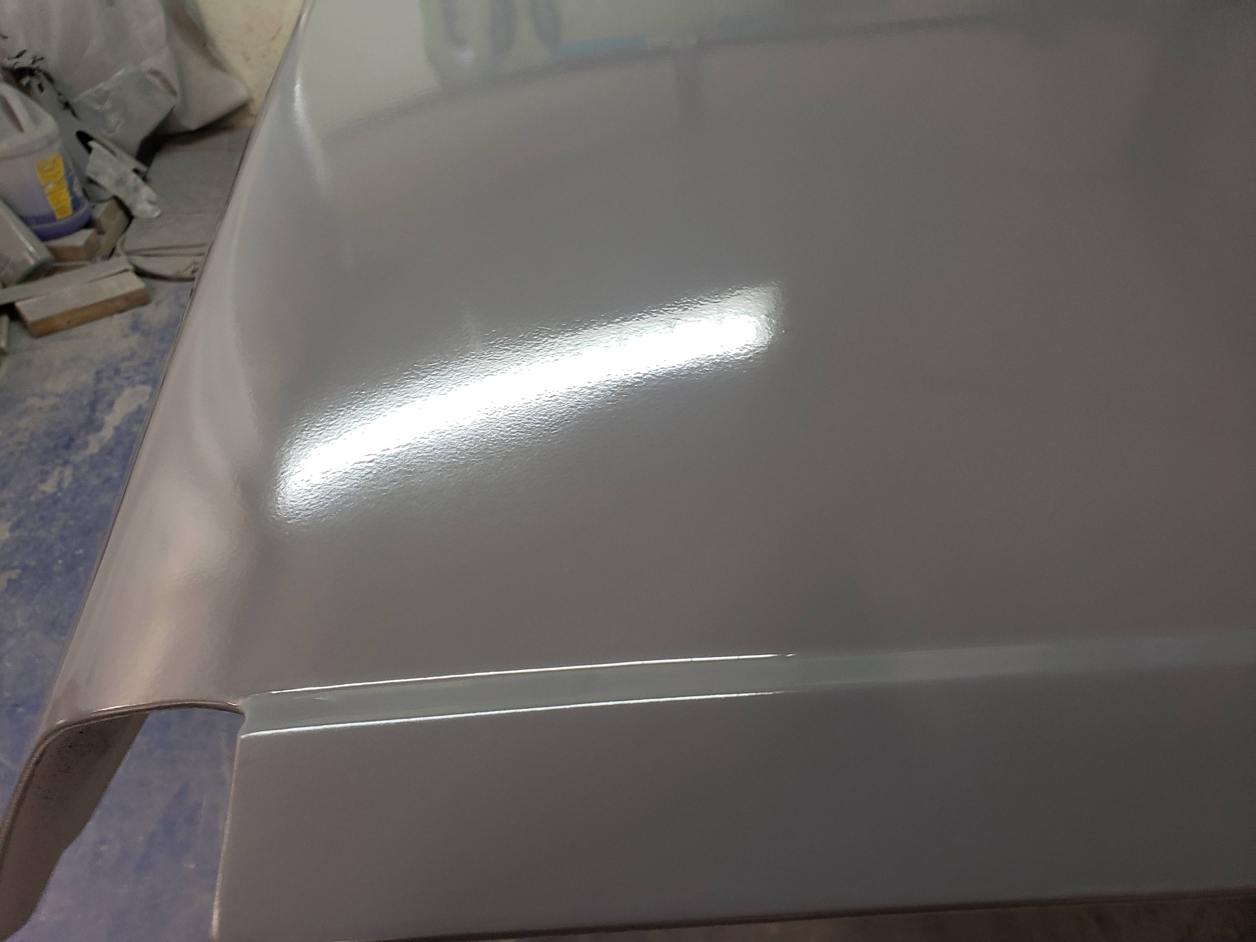

I laid down a second round of hi build on trunk lid after knocking it down with 220 on flat blocks. I reduced the primer a little to get less peal and it really came out nicely. More like an eggshell texture when dry. So I threw 320 on my DA sander and just did a little section to see how it goes since I've never done it. It's really smooth. My question is when I go to 400 grit, does blocking achieve the same as using a DA ? I just want to make sure no sand scratches reveal themselves after all is done. BTW the single stage urethane I'm using says 400 grit as last step before sealer and paint.
This pic is before she flowed out and dried. Much less peal after a few hours.
This pic is before she flowed out and dried. Much less peal after a few hours. View attachment 202074
