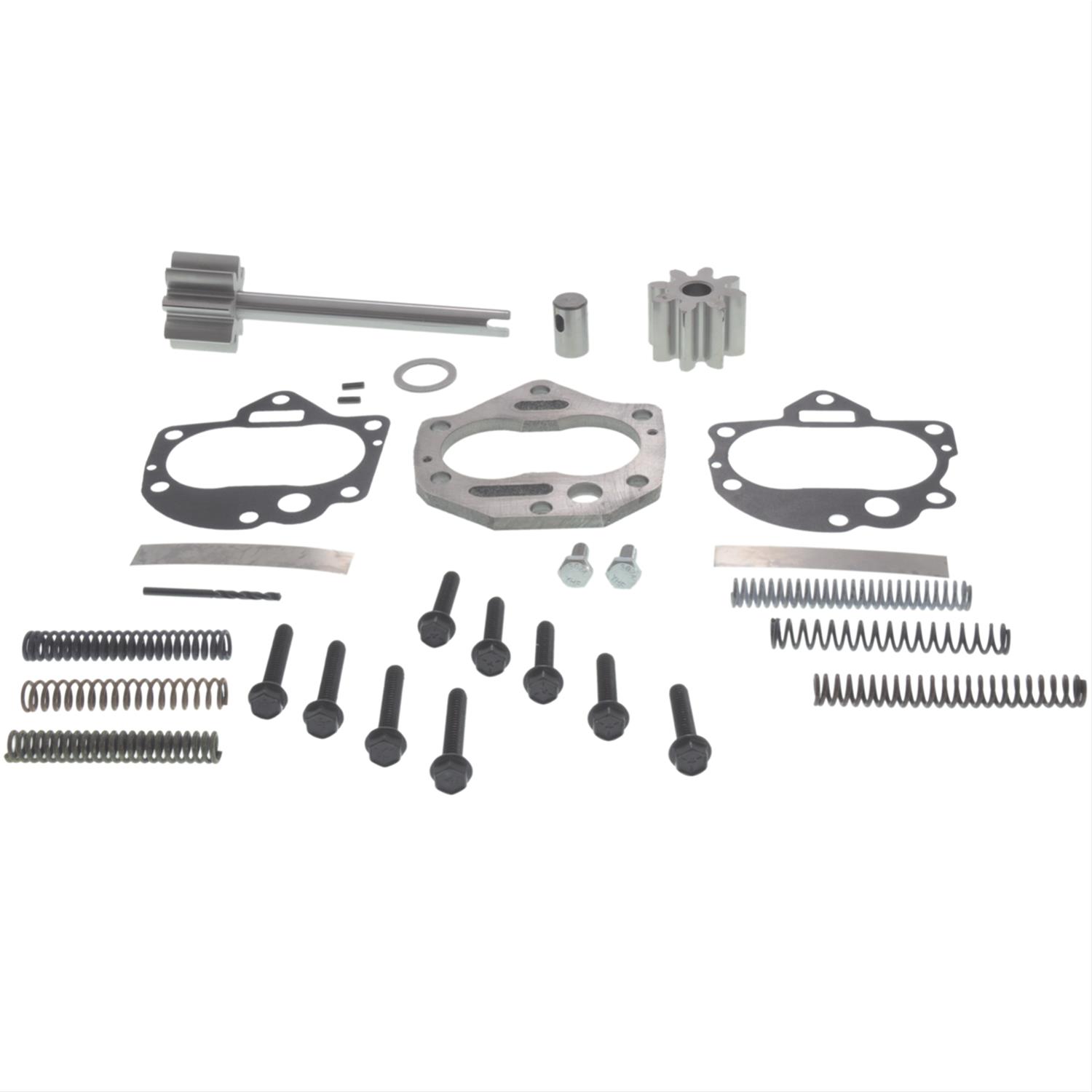

If in fact its a buick engine. Id be more worried about oil pressure if in fact it's leaking from the oil pump assembly. If it is there is and going to take it apart invest in a rebuild kit. Make sure you prime the engine with a drill first to build pressure before firing engine or nothing but bad will happen.
