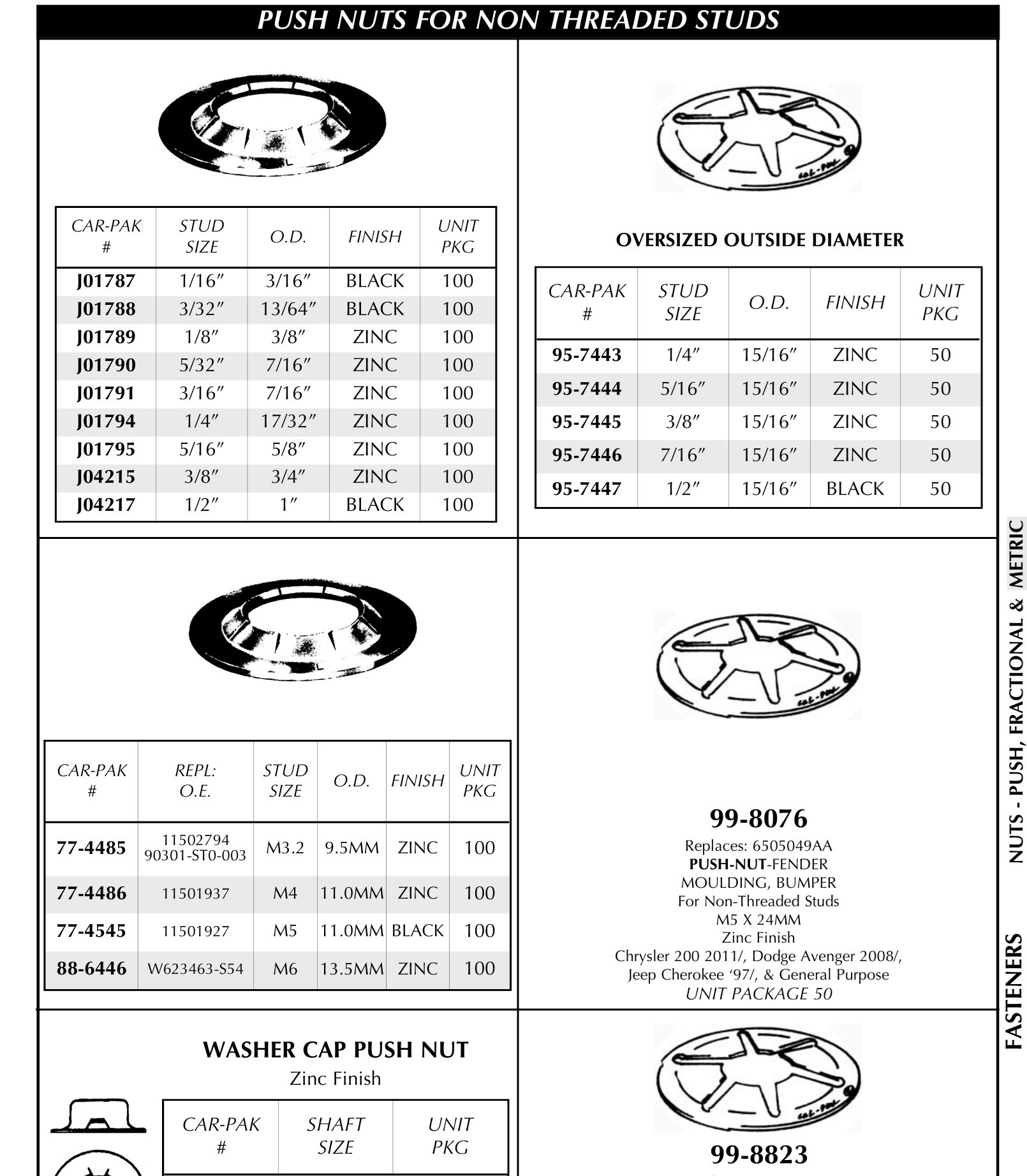

GM # 381700
Car pack has them in 100 packs. Measure to be sure but I think they are 3/16".
Disco
Also avail able at a lot of hardware stores if you don't want 100 of them.
