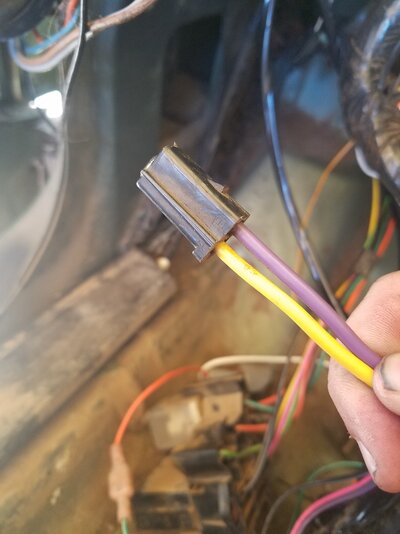

Hello all
I am pretty sure when I bought by 79 el camino these wires were not hooked up. Now that I've gotten my dash ready to go back on I'm trying to figure out where they go. It looks like they might go down on the column, neutral safety switch area but my old column only had one connector down there. Any help?

They go to the switch for the clutch pedal. It keeps the car from starting unless the pedal is pressed .
