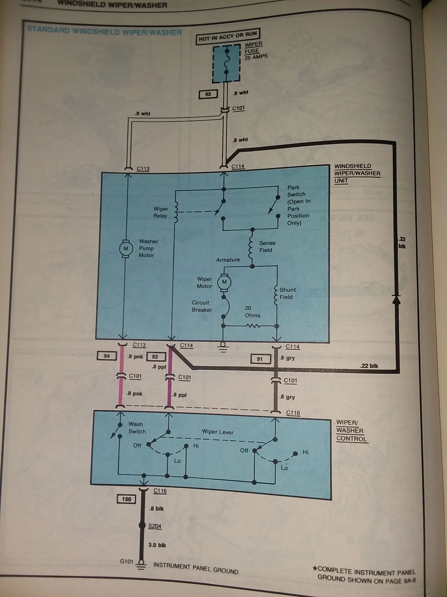

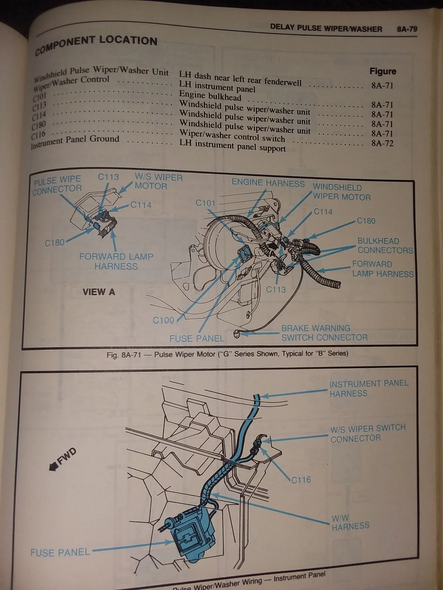

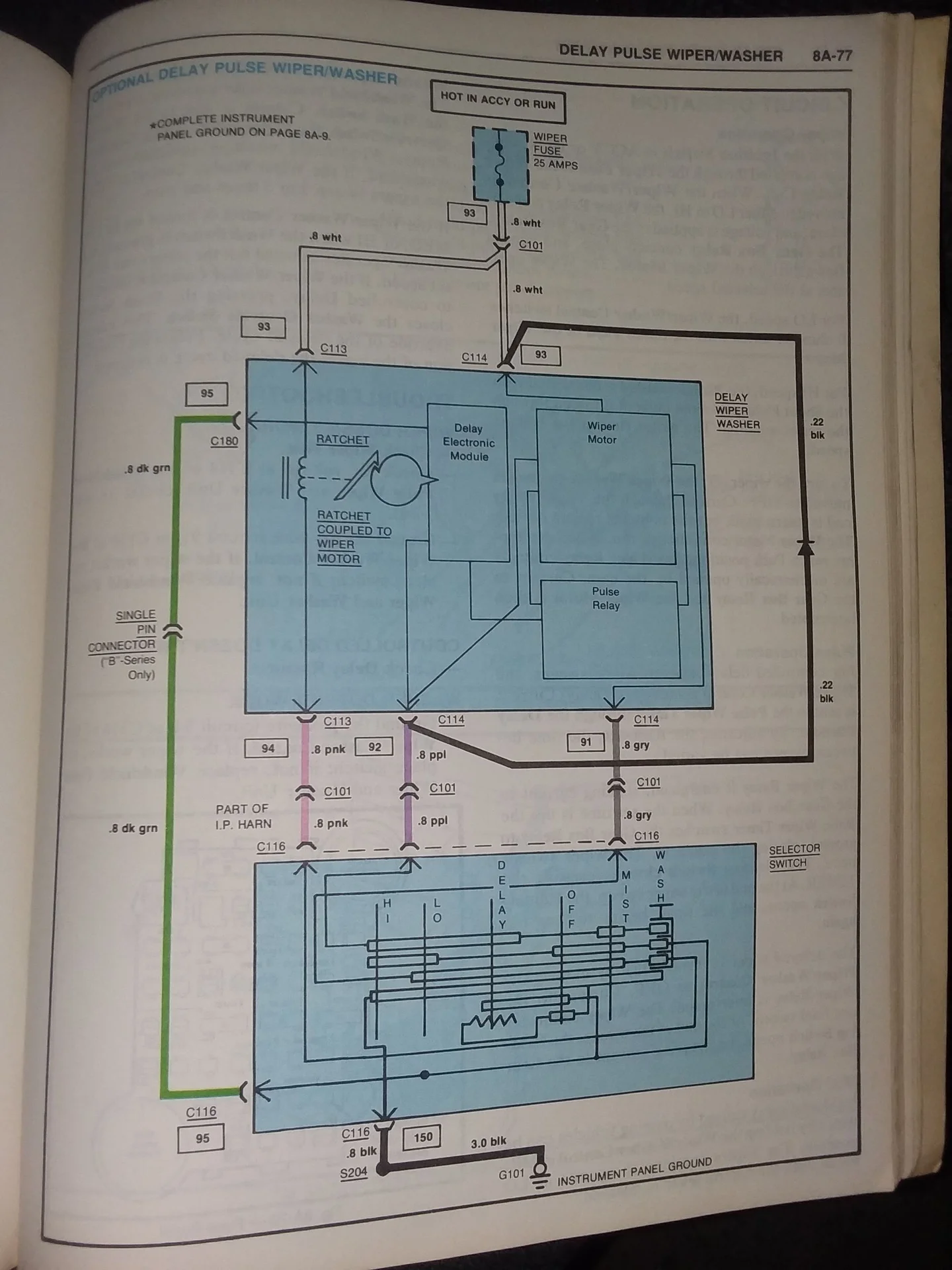

Ok so basically without a build sheet no real way of knowing what it came stock with for options and would it include like the delay or non delay side of the wipers not the switch or is there a way to tell them apart just from the moters I got a lot of the wiring figured but I seem to have no connections for wiper controls so trying to figure out what I need to make them work or even if there was some kind of retro fit or easyish way to get them working
