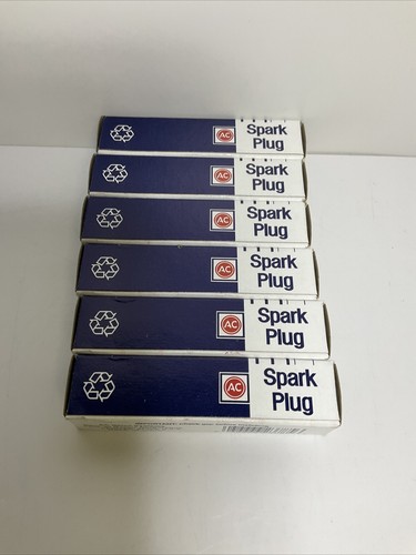

I'd replace all the plugs with new ones gapped to the recommended 0.045". That 0.067 is way too much. You also have a spark plug ending in "SX" which means special gap with extended tip. Don't know if there's a bulletin out on 84 229 engines saying to use those, but your original numbers weren't an SX plug.
Your engine calls for R45TS spark plugs. GM p/n 5613957. If possible, always try to get the vintage old school AC spark plugs. I don't care if platinum this, or super-core that on the newer plugs. These cars in stock form perform well on the original style plugs even without all the newfangled designs/materials. Many times for less $$. For GOD'S sake don't waste money on Bosch crap unless it came from the factory. I'd use NGK plugs if I had to use something other than old style AC plugs, but you can never go wrong with the correct, old green-inked AC plugs.
$22 plus any tax delivered. Set of 6. Looks like he's accepting offers as well.
Ah, good to know.
The plug I pulled out is an ac delco R45TSX.
