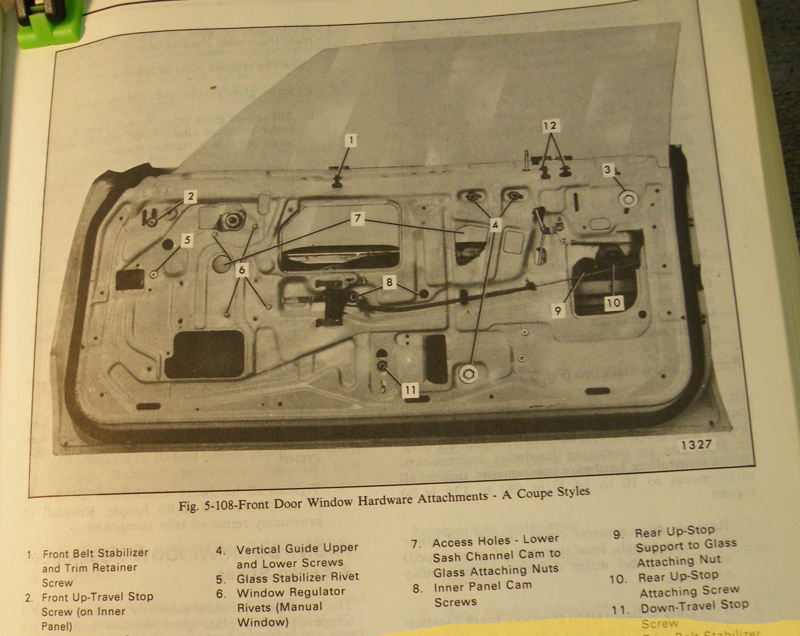

Hey guys, How do I access these? I have the door panel off, the glass covers some of the screws. I also have new door hinges, any tips?
Number 11 for the bottom stop. Mark it before loosening it so you can get it back to proper alignment without fighting it.
Thanks guys. I will have a look tonight. Great pic ELCAM. I found this video for glass adjustment. I circled one of the bolts in RED. On my car, there is no slot at this location, just a bolt. ???
