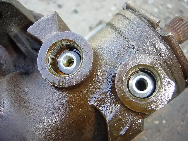

Flared adapters. This style is inserted into the holes in the steering box. Gets rid of the huge adapters to give it more of a factory look.

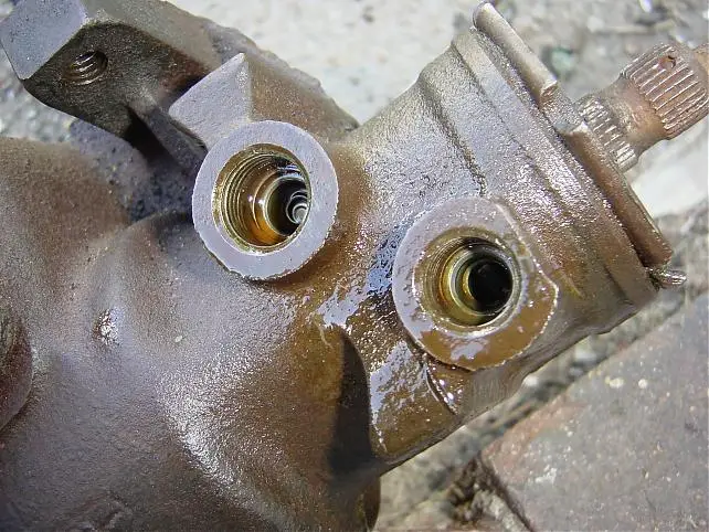

This ain't my junk, just some pics for examples. O-ring style hoses removed, waiting for adapters.
Adapters in place, ready for the flared hose.

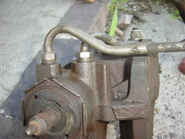

Original flared lines in place on the "newer" style box with the adapters installed.
