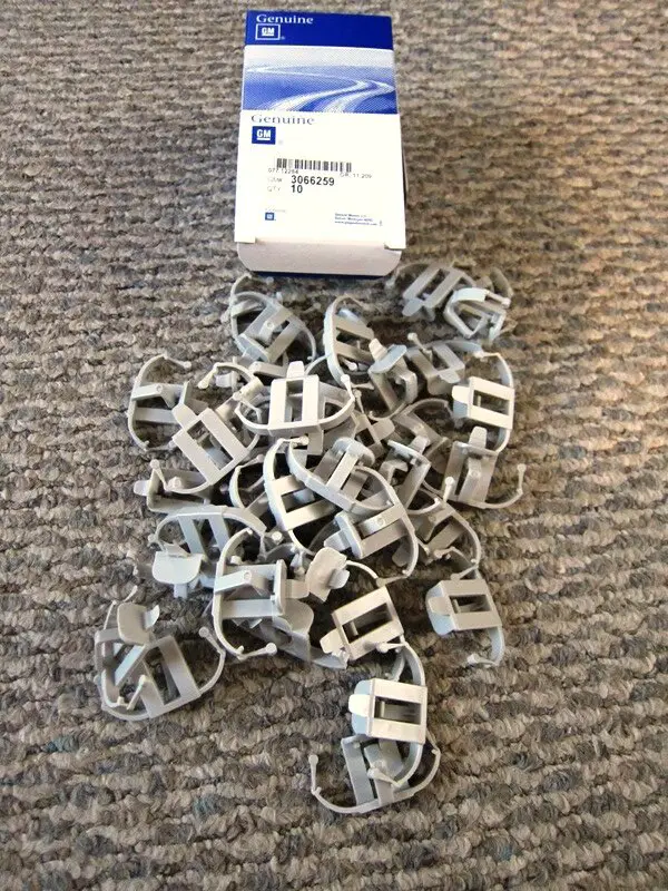

You may need some of those special umbrella clips for the lower trim. Again, depending on the car dictates the number of clips needed...p/n 3066259
If you find you need some umbrella clips, hit me up. I might have a few. 🙂
Wow... that's a clip hoard!

Can't recall whose car this came from, but here's 6 of the 8 umbrella clips installed on the filler panel. Note, you're looking at the bottom of the filler panel. The "U" part of the clip faces downward when installed correctly.
